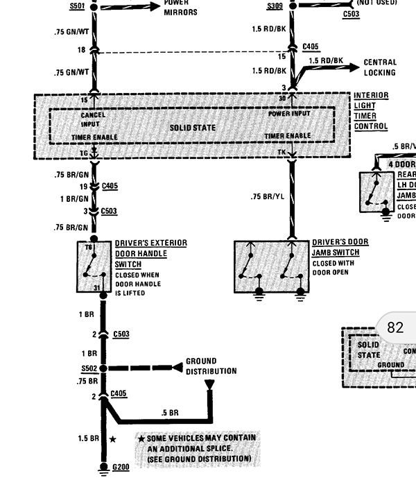

                  Good call... I have the manual, here's the offending circuit:
                  If I'm reading this right there's just two switches and grounds on this circuit.

                    The central locking does have a weird loop that feeds into it. And You could have a bad door "pin switch" that is crusty. If it was just the right amount of crust-ness, it could be constantly triggering the interior light relay.
                    There's also a micoswitch in the door (not seen in that pic of the ETK) that all have failed 20 years ago - it's the pin on the relay hat is the small one.
                    Originally posted by Matt-B
