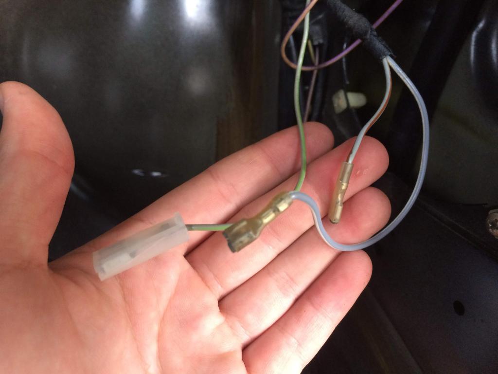

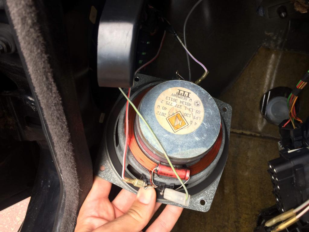

          1: Since I'm not touching the stock amp, should I even bother with removing it rn? Not sure if it even works, since only 1 of my OEM speakers (rear right) currently work, lol! I took out both of the 5.25" speakers (neither work) and noticed that there were three connections to them (wtf). Is this factory? It's green and grey, can't find any info of it. Can't be tweeter above right? Here's a pic or 2. Polarity seems fine, speakers jump, but won't produce any sound!

            Ok I think the third connection is for the fader, which doesn't work with the after market head unit...

              Honestly I've never worked on a stock e30 system, so I can't help you much on number 1. The fader throws a whole other set of wiring headaches in there. I am sure there are threads on here that detail the stock wiring but I've never had to go that route. The stock wires are fine, twisted wire. If you have a meter and a way to just test the connections than you should be able to trace the wires.
