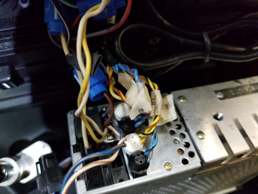

    I recently purchased a 1991 318is. The car came with a non functioning BMW CM5908 radio (works randomly and when the car is shut off the anti theft portion of the radio will beep until the battery has drained). When I pulled the radio it was obvious that the car did not come with this unit since the wiring connectors were spliced on.

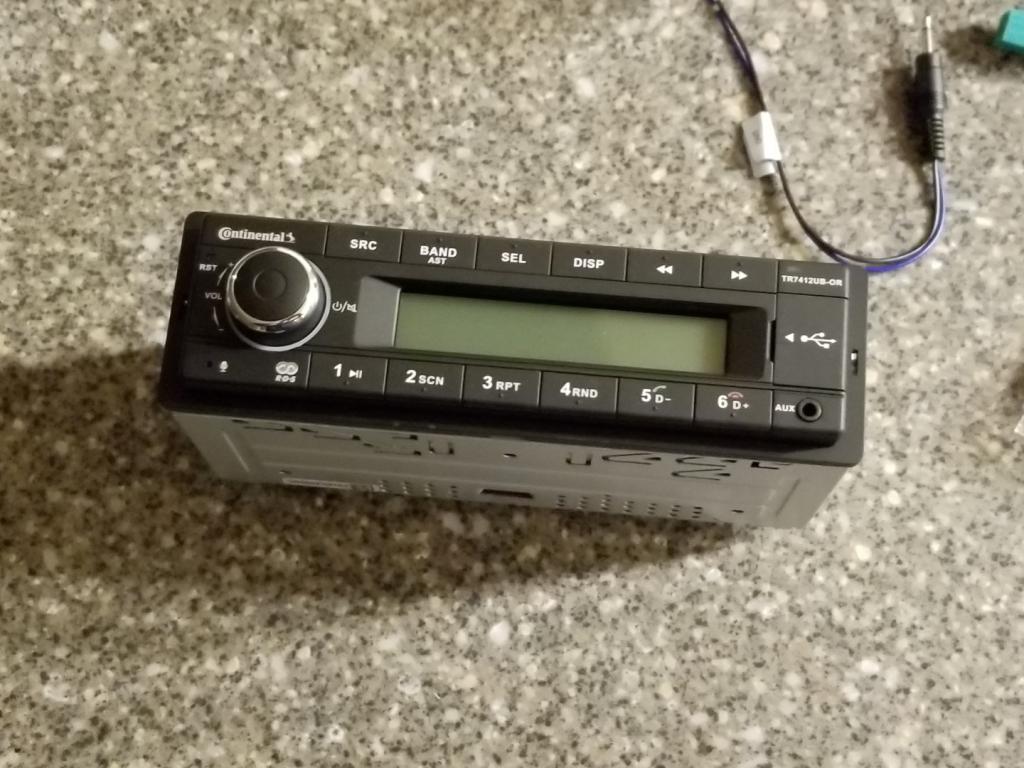

    I ordered a Continental TR7412UB-OR which accepts an ISO plug. The CM5908's wiring is very different and was hoping to get some help figuring this out. I purchased an ISO to E30 adapter from Ebay but the E30 part does not work with the CM5908.
    Here is the new radio:

    And here is the wiring from the old radio:

    Any help here would be greatly appreciated.

    I would splice the wiring from your e30 harness and fit them to the Continental. Make sure you get the right diagram, check if you have the fader switch. It is pretty straight forward.

        I really recommend getting the universal ISO harness for the conversion, i used one for my continental and made things alot easier to cut/strip the universal harness and the old radio harness and crimp on new connectors. If you go the same route heres a quick guide:
        Car Harness: -> ISO Harness continental:
        Green/red -> Yellow(constant 12v)
        Grey/red -> Orange(illumination)
        violet/white -> Red(ign. 12v)
        Brown -> Black(ground)
        Blue/red -> grey(FR+)
        Blue/brown -> grey/black(FR-)
        Yellow/brown -> green/black(RL-)
        yellow/black -> green(RL+)
        blue/brown -> violet/black(RR-)
        blue/black -> violet(RR+)
        yellow/red -> white(FL+)
        yellow/grey -> white/black(FL-)
