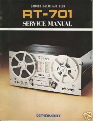

                          That's the one!!! So do you think I overspend? $10 bucks that is what two cups of some Frapulatemokachinoventy?? lol
                          Man I have records, cassettes, eight track (just for nostalgia they suck) and my latest addition a Pioneer 7. Anyone have metal reels laying around, need some to make it look cool, only have one for now the rest are plastic.
