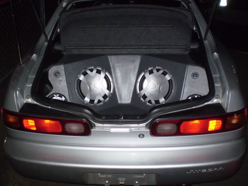

    So I am finally gonna show youse guys a pic or three of some pretty work, something I am actually proud of.
    I have not taken the time to do a real photoshoot, but sooner or later I will.

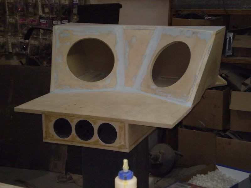

    This install is all MDF, except for a tiny bit of filler. Kind of simple, but clean.
    This car hits about 147db, and anyone who hears it is impressed.
    Here is the breakdown:
    2 Exile XP12 DVC subs in 3.88 cubic feet, tuned at 33Hz.
    2 pair of Exile XP65 Component speakers
    1 Exile 1200.1 Mono Subwoofer amp
    1 Exile 600.4 4 channel amplifier
    Some cheapass Pioneer headunit, I think DEH-P660. CD skips at high bass, poor old piece of shit needs a hard drive!
    Anyway, a couple of pics: Kind of a tight fit
    A simple design with a bunch of fitment work:
    Finished box, ready for vinyl:

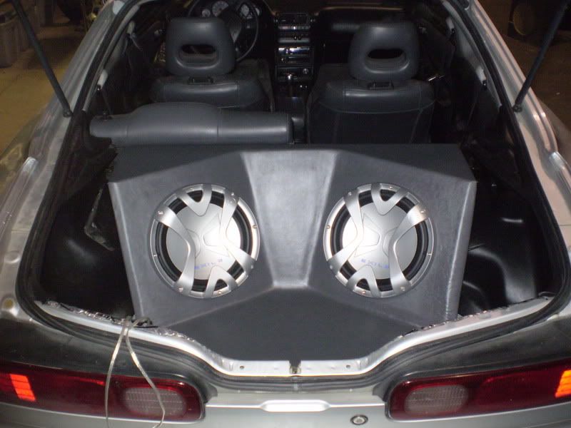

    Wrapped in 1 piece of vinyl. Took 5 people about an hour to wrap this thing!
    Tight fit in this '97 'teg: doing sidepanels for seperates in the hatch.
    I think it is nice that these woofers come with grilles. Great touch!
    Here is a shot of the complete system,but you really cannot see shit. Camera work is not my speciality...
    I wish I had shot the amps. They are on the floor, on either side of the car. Kind of a waste of space, but really cool IMO.
    Anyway, just wanted to show a bit of my work.

      sick! teggers are cool little cars...try mounting the amps behind the rear door cards...i read that on here a while ago....pretty cool idea...did you get rid of the speakers in the back seat...or did you leave them?

        I have seen this car in person and it FUCKING POUNDS!!!!!!!!!! I have never heard something so loud and so clear in such a small amount of air space. If you know anything about subs you know that accomplishing both loud and clear in any compact car is a true feat.
        Great Job Luke

          Nice work! Components in the trunk is hilarious ;)
          Had same gen integra before with two IDQ v2 12s and a single phoenix gold zx amp, each sub was in 1.2cu.ft sealed and it was damn loud with only 150wrms to each sub. Reliable, fun car too.

                That some crazy angles you have to deal with - that's what impresses me.
