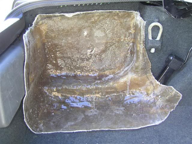

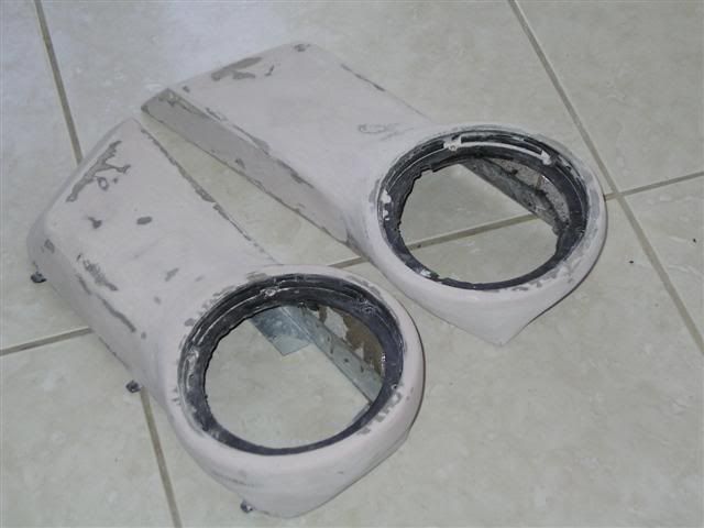

    I know some of the locals peeps have already seen this in person but, I finally get around to posting some pics of my audio build for others to see. The DIY mobile site was a big help as this was my first time with the itchy stuff.
    :D

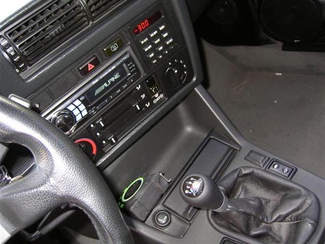

    Radio.

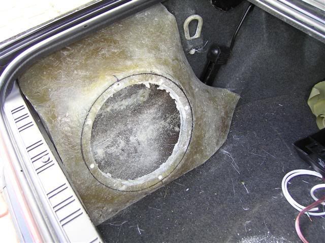

    Mold for box. perfect for 10"
    Sealing up the outside.

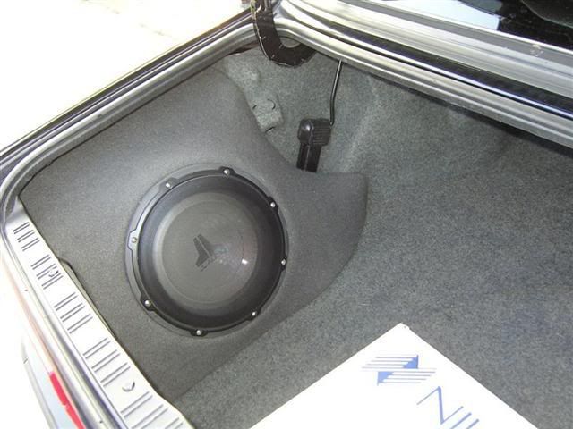

    Completed box. 1 JL.

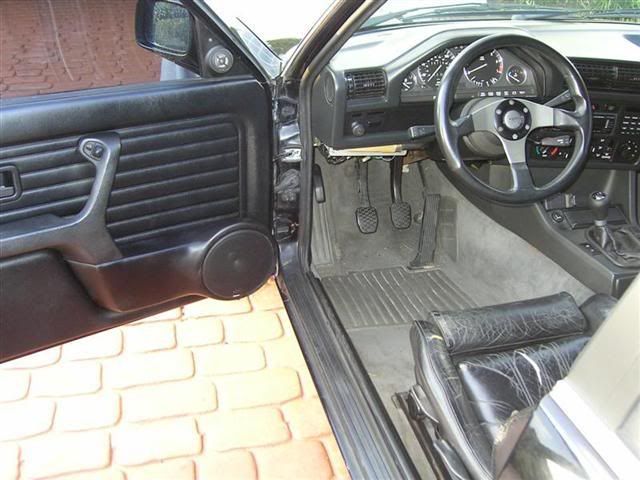

    Molding in the MB quart rings into the door cards.

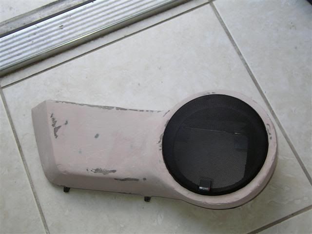

    Testing the grills.

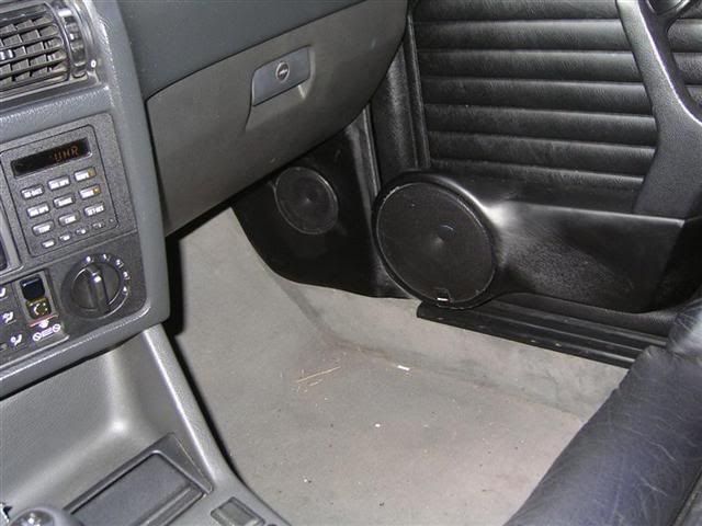

    Completed right side triple wedge. 6.5" Doors, 4" in kicks & tweets in the stock location.
    Driver side.

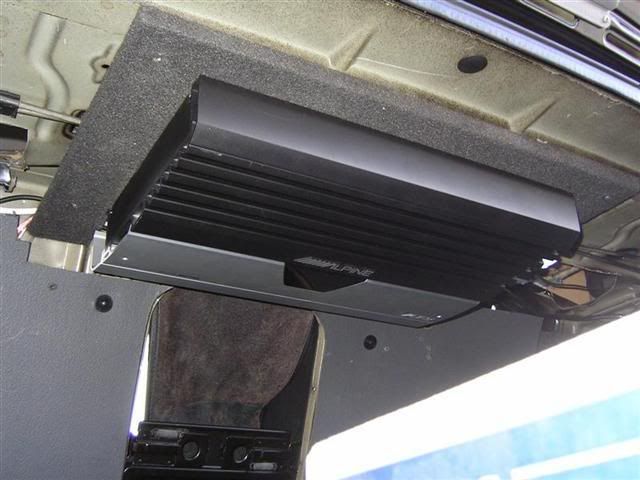

    Amp Location.

    Looks good but I can't tell where that amp is located. Where?
    When are you going to start building more of the 10" boxes for the rest of us to buy? I am in for one

      AS far as the amp goes, its located up under the rear trunk lid.

          Thanks Mastrcrus, I am surprised no one has made some yet except for they are time consuming on a one at a time basis. Kind of tricky at first getting the timing right and such, but I am no pro. The mold is pretty easy to remove for you track guys.
          Vedubin, Is correct the amp is mounted under the rear deck out of the way. Thanks Gordon, for the props you got to see some of the build and suffering I'm very happy with it so far.

            I had my spare tire well glassed into a massive mox for a 15 before, but that was just for extra airspace

              Looks great. The door speaker pods turned out great.
              Doesn't your amp overheat in that position? You're generally not supposed to mount an amp upside down because the heat rises back into it instead of dissipating away. At least, that's what I've heard.
              It's very cold where you live (-300). lol

                I would follow Andrews advice, though, and mount that amp differently.
                What I do when a customer demands that location is to use long bolts through the rear deck (generally 1/4") with a nut under the rear deck to stabilize, then mount the amp with more nuts above and below the amp, so the amp sits about an inch (or more) below the surface.
                On the other hand, if it isn't shutting down, what the hell...leave it.

                  It might be because of the way it's being used in this set up but I have checked it after quite a bit of abuse and it gets just slightly warm, but not hot at all.
                  It sounds really clean and loud, I am only using "75 watts RMS" to each side in the fronts and 150 rms into 4 ohms for the sub. It does not allow bridging or anything like that and is the main reason I went with that sub. Both gains are set about half way. Like you said Luke, it will stay that way for now.
                  Later on I will be adding a Audiocontrol 6xs o r something like it because the Alpines "crossover" does not give me the tweaking I would like.

                      Netcsk, Patience is all you need. Get a spare set of door cards like I did from a local Junkyard to play with. They are not that hard to build, I promise. If your interested in making your own, Midrange must still go in the kicks. I fiberglassed those too. If you want PM me. I will make a mini write up for you and it will all make sense. They Vinyl was more of a PITA. They work well for Midbass, not sure about midrange.
                      As for the Amp. I had it mounted on the rear wall when I had a set of 6x9's. Looked nice but. I wanted to make use of the extra space.

                              Okay I know this thread is dead... but how do you make a mold like that for your trunk without making a mess? Do you justlay down plastic and lay the glass on top of that?
