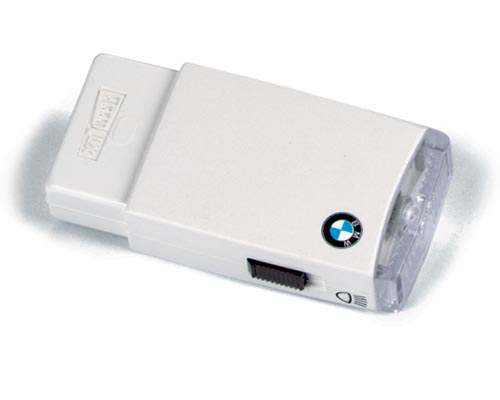

        It's like a flashlight charger that plugs into the left side of your glovebox. The brown is ground.... I thought that the red/yellow was power, but only when the car is on.. hmm. Check this out.. see what you can find with these wiring diagrams..

          Yes, it should be the charger dock for the BMW glovebox flashlight.

            Ooooo .. glovebox flashlight. Perfect, just what I need. I guess I'll use this as a power lead to hardwire my radar detector.

              Check it with your meter because it might not be 12 volts or enough amps to power the detector. The circuit is designed to prevent the flashlight from overcharging and it shuts off intermittantly.

                its 12 volts

                  Yea, just to repeat it. It definitely looks like the flashlight connector.
