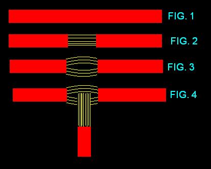

                One thing that I like to do is to remove a 1/2 inch section of the jacket further down the wire, then I will split the strand bundle apart and twist the new wire into the middle of it.

                    As far as what Jscotty said, that is a great way to tap a wire, however, it leaves a spot for corrosion to form as the only protection that you could put on it is tape, since you can't slide shrink tubing over it.
