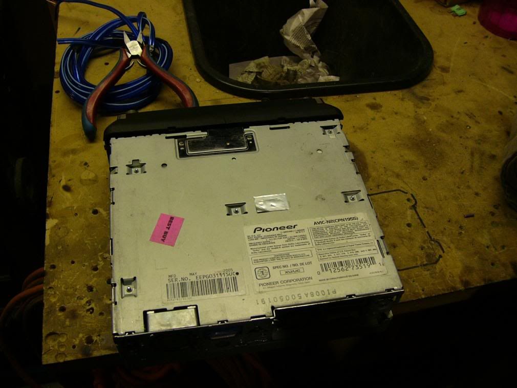

    Here is the deal: If you connect the two points on the circuit board, it will allow changing destinations while moving. So, flip the deck over onto its back. Find the little silver label:

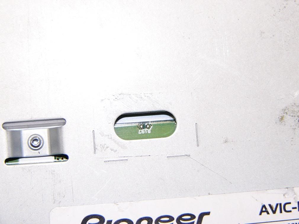

    Now peel off the silver label and set it aside. You will see 2 tiny solder points, like this, labeled "R197":

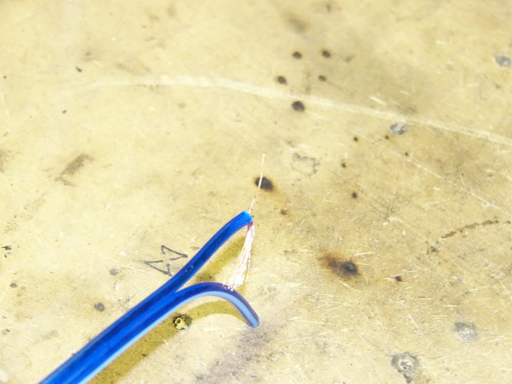

    Take a thin wire and separate a few strands. Apply solder to them so they are easier to work with:

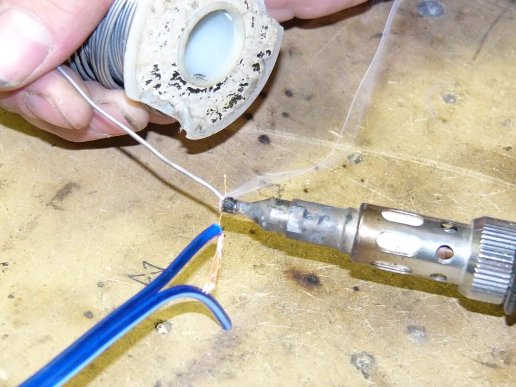

    Now with solder:

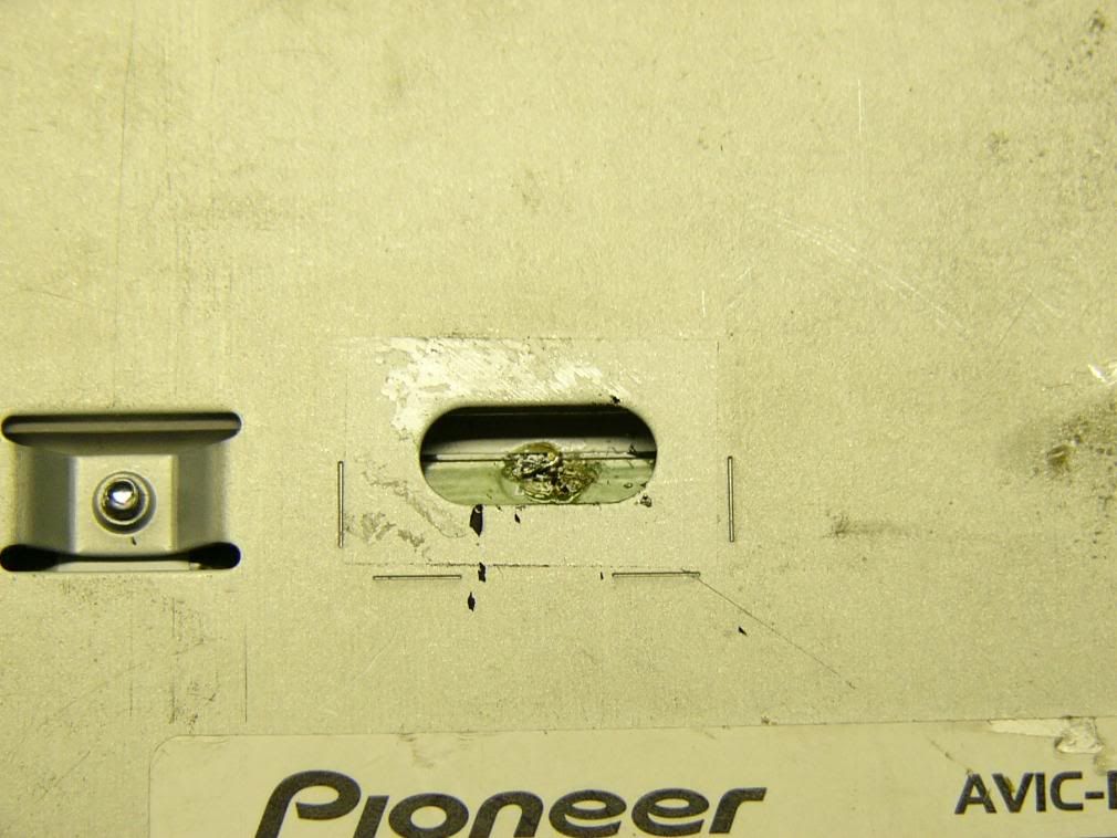

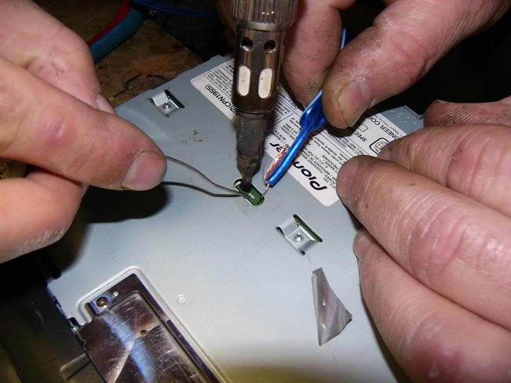

    Now CAREFULLY apply this bit of wire to the board and solder it in, like this:
    This gory mess is what came out...possibly the ugliest solder joint in my life, but I was not willing to temp fate and try to fix it:
    After a quick reinstall, I now have the ability to use my damn Nav deck how I want to.
