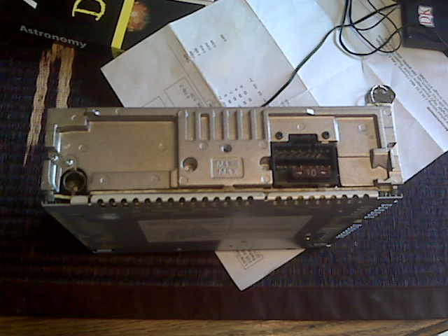

                      OK I took the head unit out and got this. No RCA hook ups. Where do I hook up the speaker and remote wire now? My dad wants me to take it to circuit city and they quoted me 75 dollars because it was a BMW, I really don't feel like grabbing my ankles and letting circuit city rape me and would much rather do it myself.

                        Are there any RCA's on the wiring harness that plugs into the radio?
                        I can't believe that there is a radio out there with Bluetooth, but not at least 1 pair of RCA's...

                          thats awesome. blue tooth but no rca outputs... hopefully the amp has high level inputs.

                            Thats what I said, i was going to put a Dual flip-up screen head-unit in it but my dad bought me the the sony head unit for christmas also, so I really don't wanna hurt his feelings by taking it out. It does have hi level inputs actually.

                              Sweet, you dont need to get a converter then. Pull out the rear speakers, splice some wires in to those wires and run them to the high level input of your amp.
