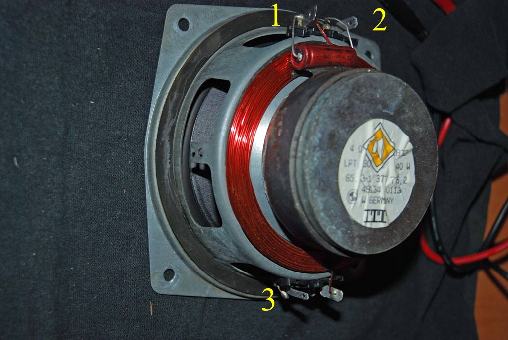

                    I ran a connectivity test and the wiring is ok. To be sure I swapped the speaker and sound came out so I have a dead speaker. For my own education and anyone else who doesn't know, can you please explain why the stock speaker has 3 wires connecting to it and what each one is. I've labelled the connectors. Thanks again.
                      What I got so far: connector 1 goes to the tweeter. The capacitor at the top removes bass from the signal before it gets to the tweeter. Connector 2 is the signal coming from the amp. Connector 3, maybe ground?
                      Let me know if I'm on the right track.
                        OK, so from the angle you posted, I cannot quite tell which is which, but the terminal that has both the cap and the coil attached is "input positive" from the amp...looks like #2 from here.
                        That would mean #1 is the output to tweeter positive, and #3 is definitely ground.
                        See how the cap and the coil attach at one point, but the coils output is on the other side of the speaker, where the actual speaker terminals actually are?

                          I did also try checking the resistance with a multimeter across the positive and negative terminals (2 & 3) and I got no reading. I'm sourcing a used one now.
                          Thanks again, I have a better understanding of how the speakers work now.
                            Jamil, check for continuity across "3" and "4", you should see 4 ohms or so. Those are the actual speaker leads...see how the leads actually go into the voice coil?

                              Hey Luke, tried it, I'm getting no resistance.
