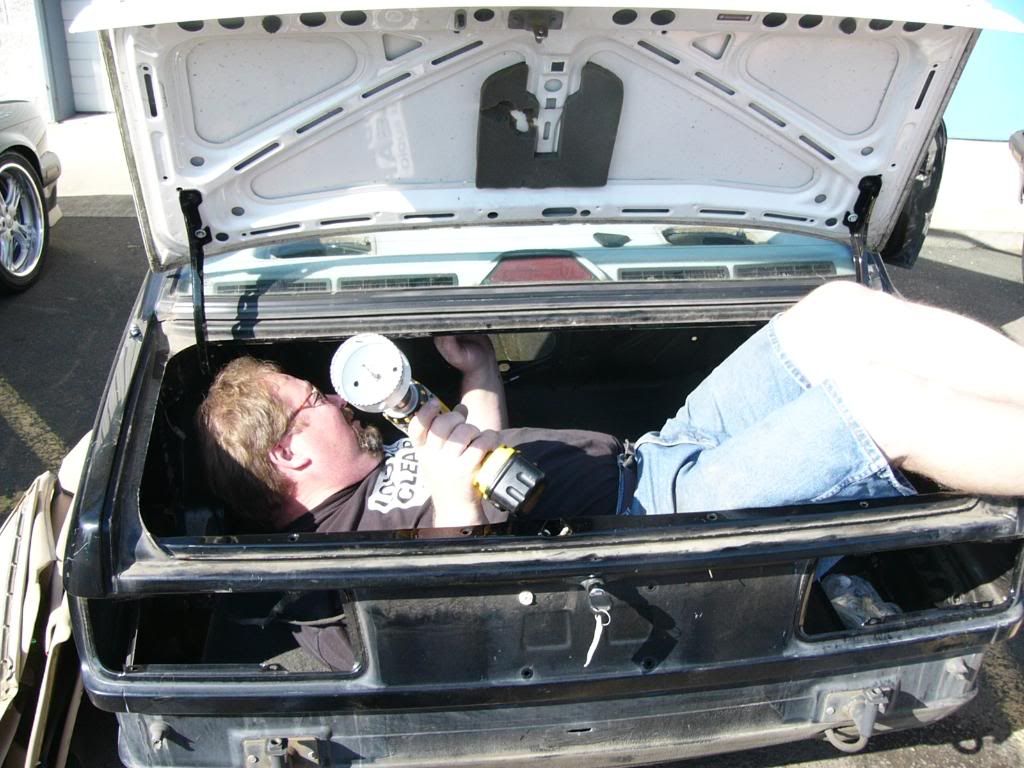

    1 1/2" screw gun with hole saw attached to installer:
    If I can get my fat old ass in this trunk, so can you. Get comfy!

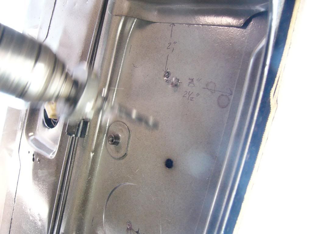

    Now, measure carefully inside the trunk:
    From the metal lip under the rear deck, measure 2 1/2" towards the rear of the car and 2" in from the edge of the brace (look where the metal lip attaches to the underside of the rear deck)
    Originally, I planned 3" back, but I moved it forward just a 1/2", so the port is easier to clear the back of the box

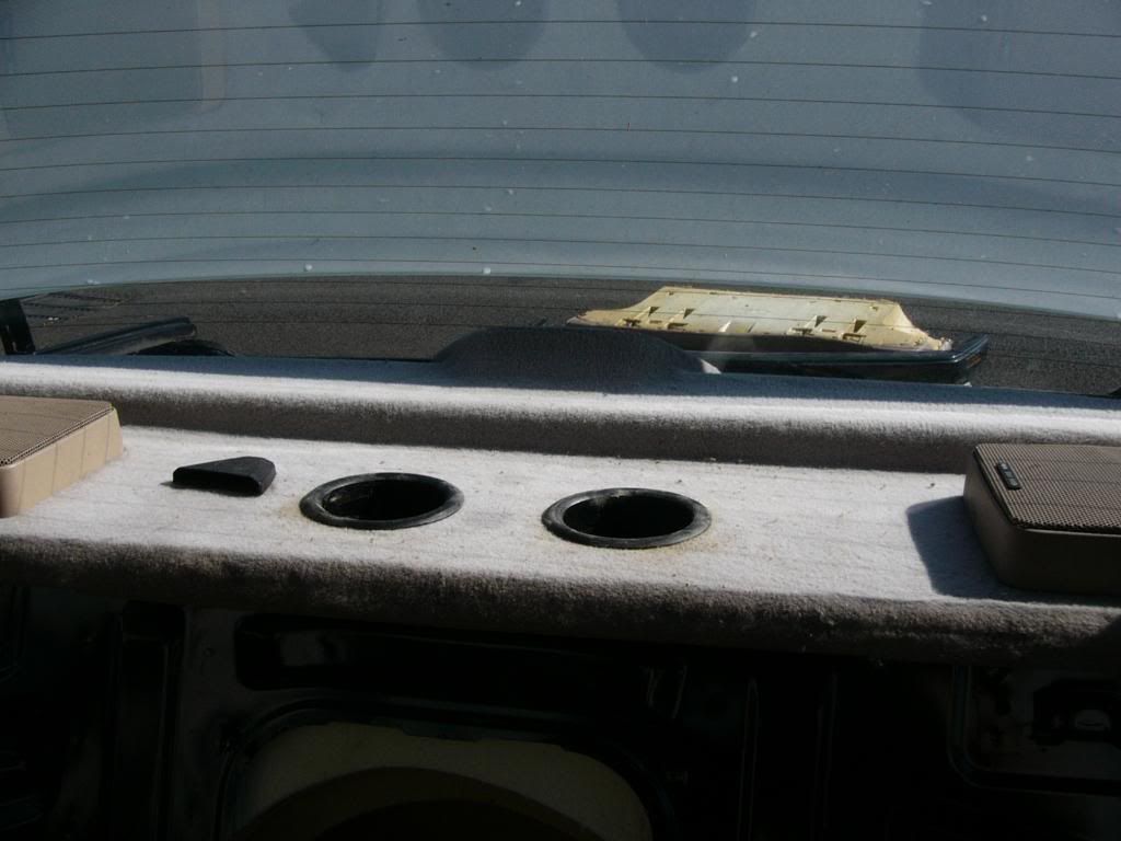

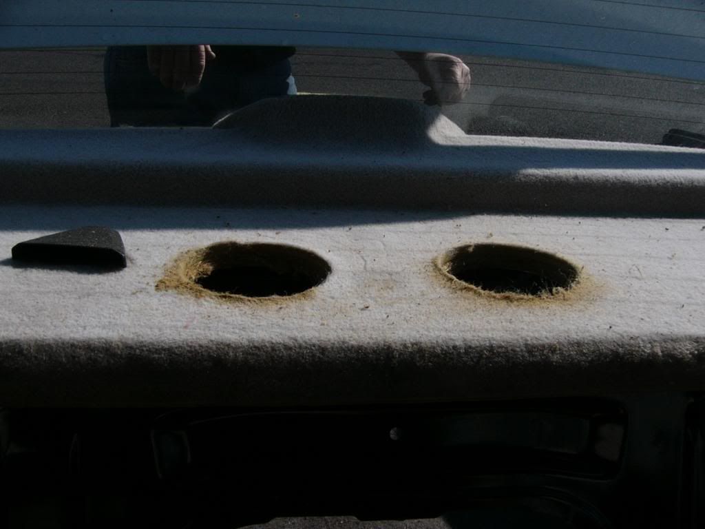

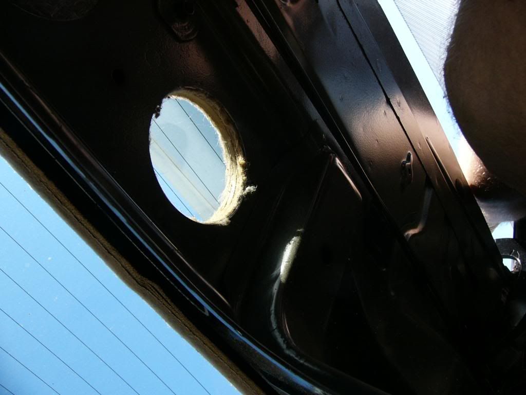

    I used the drill bit to start the holes, make sure you get all the way through the rear deck. After you have the holes done, cut the big 3 1/2" holes...DO NOT GET METAL IN YOUR EYES!!!
    First hole done:
    Now do it again...be FUCKING precise here, guys!
    IF it does not look like this, you are fucked.
