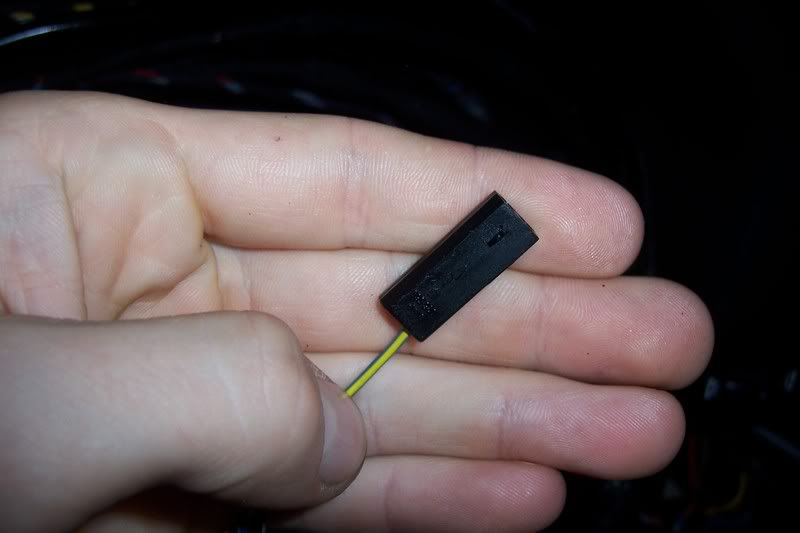

    My #12 fuse blew and the radio, computer, and speedometer won't work. I removed the radio and computer and still it was no good. So now we get to the gauge cluster. I found the one wire was not plugged in.
    Its the small wire with to female holes. I'm assuming it plugs into the bottom section under the speedometer but there are several options. Which one is correct? I can't find a pictures in my Bentley manual either. Help me please

      I think it says 12v on the plug?

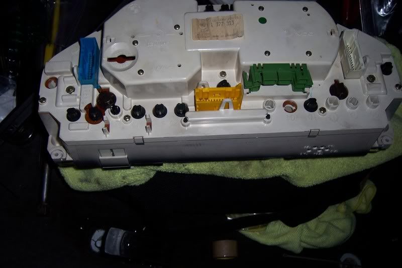

          was it the black single plug behind the speedo (on the backside)?

            Yeah :)

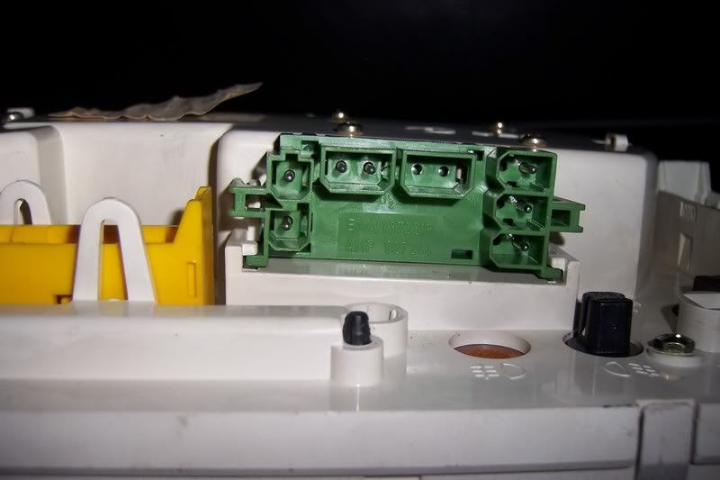

              i believe it a green section that it goes into
              I'm taking pictures now

                i was just in a similar boat. the are 2 clusters of 3 (i think) connectors each. it goes in the middle of the upper cluster. does that make sense?

                  I'm loading pics now. It will help.

                      its for the cruise control, plug it into any of those green connectors (it will fit 3 connectors which are all the same, right side of that picture)

                        Any of the three? Then why are there three of them?
                        Is there anything else that I'm missing that should go in some of those other holes?? Seems odd.

                        • archemedes
                          • 125
                          all 3 connect under the plastic

                              it means it is a "gang" plug like a common ground sort of. all the connectors terminate at the same place
