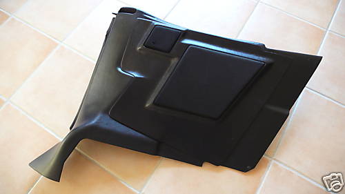

        as far as upgrades go, i saw a bmw option on ebay.de for an add on in place of the rear grill peice that stepped the mounting out an inch or so and had a spot for a tweeter in it too. i think the best option would be some kind of custom speaker box, but it would need some fiberglassing

          My option
          • StereoInstaller1
            GAS
            • 22679
            Can we get some better pics of that setup?
            Looks nice from here, what drivers fit?

                It requires a thin 5.25" speaker with a tweeter that does not protrude.
                Plus the damn thing is basically hanging in midair, so shitty sound no matter what you run. The location is poorly executed, to say the least.
                Try a set of Infinity References. Cheap, kinda thin, decent sound.
                Measure available space before you buy!
