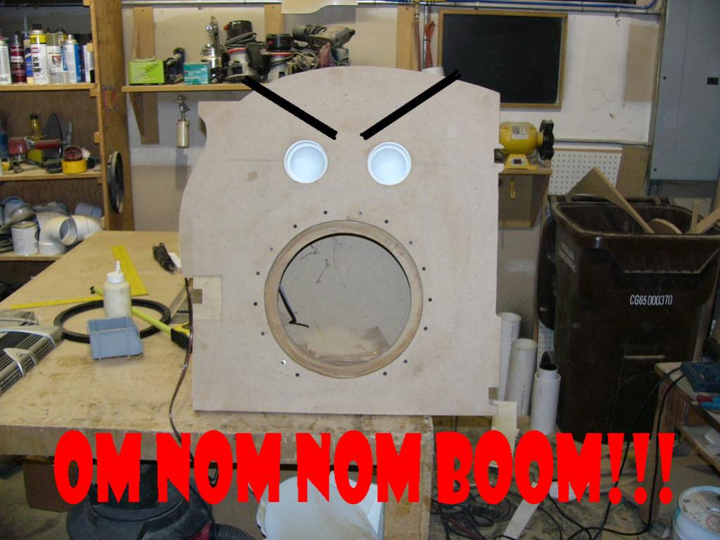

                Andy built a 10 sided box. We came in at 1.92, gross volume.
                Closing SOON!

                    Luke - 1.92 eh? that's almost large enough for a ported enclosure... hmmm. do you think the E34 spare well is larger than the E30 one? I was actually going to copy your 10 sided box. I tried fiberglass once before, but it was my first atempt and a major fail! haha.

                      That was an E34 touring, second in 2 months I have done.
                      Actually, Andy did 90% of that install, including the box build.
                      I mostly did the front mids...which took me about 10 hours of thinking and 3 or 4 hours of work.
                      You should hear the fucking midbass...best "thwack" of any E34 I have ever done.
