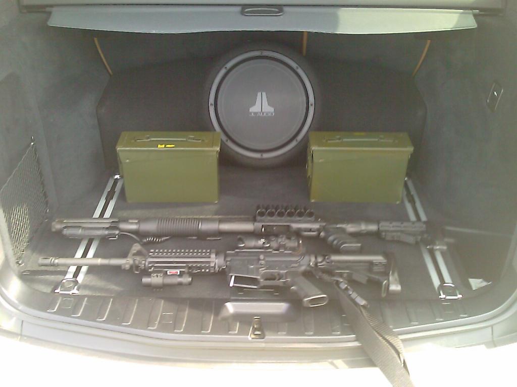

            I hate FG work as well here are a few pics of the box M4TT and I built for my wife's X3

              finished box. Ignore the homeowners protection package

                I like your guns.
