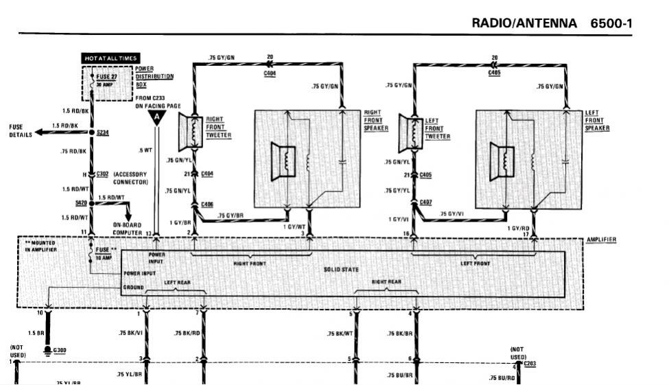

                      K i am looking at the electrical troubleshooting manual and it appears I am wrong. There is another wire going to the tweeters, its just not hooked up to the back of the speaker directly, apparently....

                          Ok so after some head scratching, I need to just cut the Gray/Violet and Gray/Red on the left side, and the Gray/Brown and Gray/White on the right side, from the car's wiring, and use those as my inputs from the head unit. Will do so in the morning and report back!

                            • StereoInstaller1
                              GAS
                              • 22679
                              OK, so in the AM, take a MUCH closer look at the wiring behind the fronts.
                              Look carefully at the mid. You will see where there are 2 inputs that run into the crossover, then a pair of wires going to the tweeter...unfortunately, the tweeter wires ARE common grounded.
                              What you need to do is look further down the harness and find the second tweeter wire and disconnect it from the signal ground.
                              You will find green/yellow and gray/green wires coming from the door jamb. Those are the 2 tweeter wires. Make sure you disconnect the green/yellow from the gray/brown...that is the common ground.
                              The crossover in the speaker is plain old 6db/oct...so that means the decks negative goes to the tweeter and the mid. The tweeter goes to the terminal that is connected to the cap, the mid runs through the coil.
                              These are one of the goofiest wiring setups in history.
