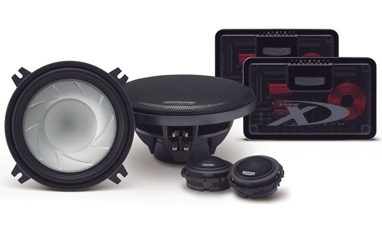

        You would put one 5.25" speaker in each kickpanel and one tweeter in each tweeter pod, meaning 4 speakers total. Plus the subwoofer in the trunk. Here is an example of what you get when you get a "component set":
        (2) 5.25" speakers, (2) tweeters and (2) crossovers (usually) - Crossovers direct high frequencies to the tweeters and midrange frequencies to the 5.25's while filtering out everything else. Some amplifiers have built in crossovers.

            These are the speakers you are thinking of getting, correct?
            If it is, that is all you need. That comes with 4 speakers (2 mids, 2 tweeters) and 2 crossovers for $350 (or $180 from where ever you found them).
