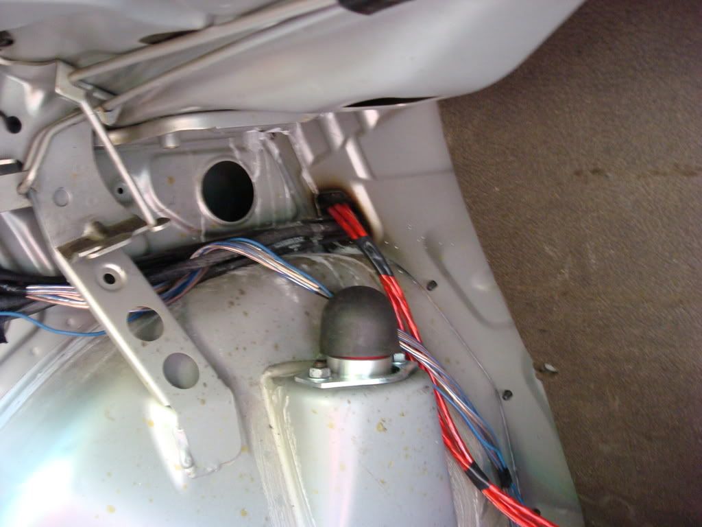

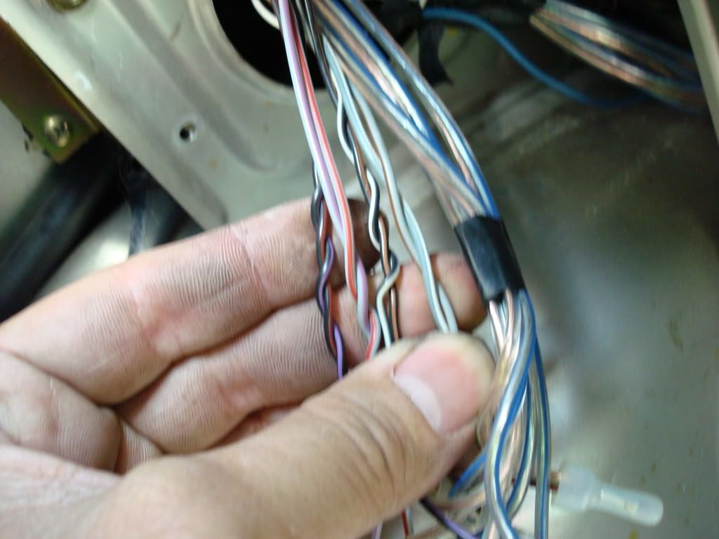

                here is my setup
                Factory wires paired up
