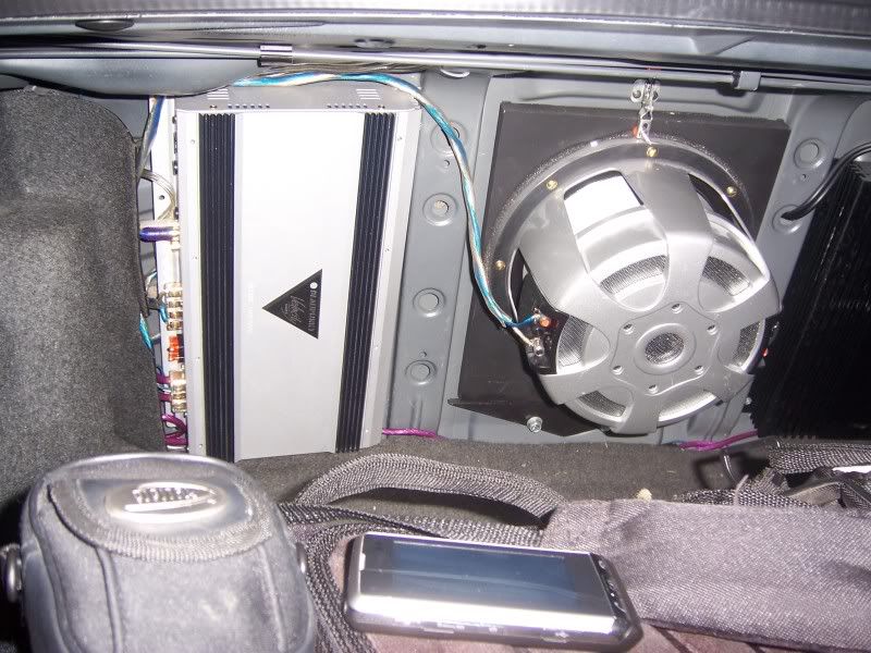

    I kinda sorta did one. I would call it more free-air, since I didn't plug all of the holes in the trunk. Sounds good with my setup, but I have a 10" sub made to do it that can do the needed excursion with the needed power.
    Notice the clamp that allows easy removal. I designed it back before I had a rack for the snowboard. It has been in for about a year and a half now, and is now on a different (non-shitty) amp.

      Pictures of the Blaupunk mounted please.
      I meant firing into the seat's back.

        Ahh. Forgot who sold me the amp :).
        I'll snap a picture sometime. work wore me out too much today to move except to eat and go to bed.

          There she is!. It fits well and I realize I pump more power to the sub than I thought.

            Maaan, like a glove eh? Hope you like it!

              Yep! Perfectly. Sounds great. Very clean amp.
