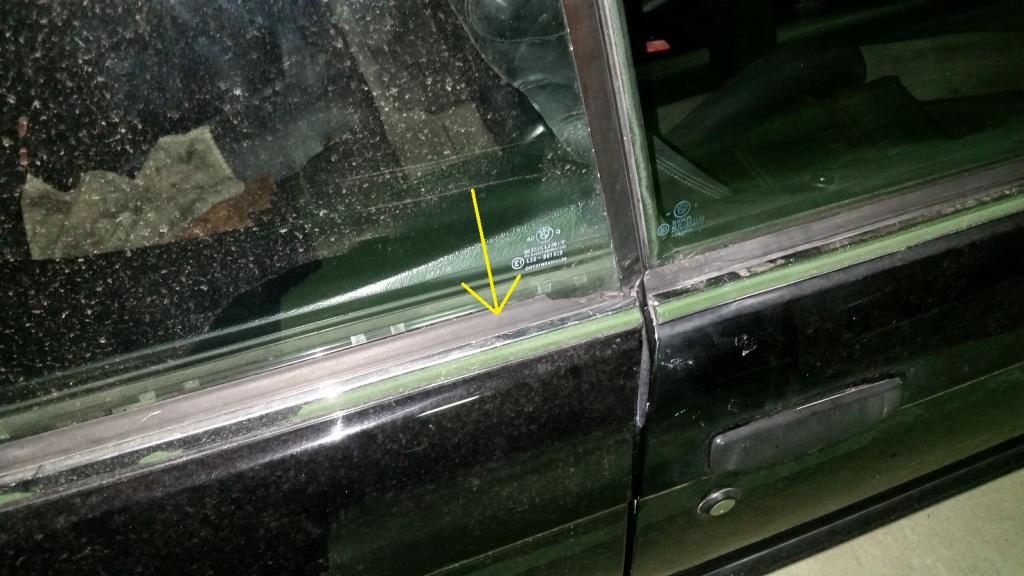

    Anyone know what the rubber molding part number is for this part of the window on a 1991 convertible? It's the part on the outside of the window but not the chrome trim. All the diagrams on Pelican I can't figure out what I actually need. Mine has a large chunk missing out of it where water can easily get into to door panels as you can see. Thanks!

    Best I could find:
    Part # : 51 36 1 933 752 on bavauto or pelicanparts
    or
    #9 on this realoem page -
    http://realoem.com/bmw/showparts.do?...51&fg=20&hl=17
    Hope this helps!

      awesome, thanks! Yeah i couldn't figure out which part was which from that diagram

        I need that part too lol are you getting water on your floors? Try ecstuning

          How is that piece replaced?

              I think you'll have to take off the metal trim piece to get at it. I don't know for sure. Or maybe you can just roll the window down and get to it

                Here you go, it fits just right.
                Drivers side- http://www.eeuroparts.com/Parts/3504...r-51361933751/
                Pass- http://www.eeuroparts.com/Parts/3504...r-51361933752/
                Just remove the inside cover part, Big part that covers the whole side in the rear and open the door to install. Your welcome.

                    I just did mine, pry the aluminum trim piece upward to get to the molding. The molding also comes off the same way, pull it off upward.
