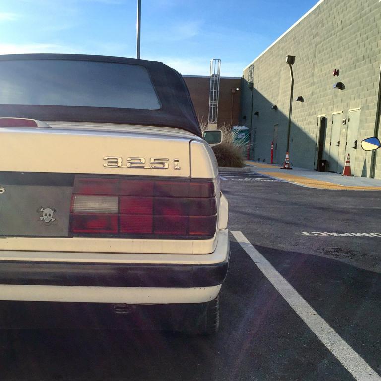

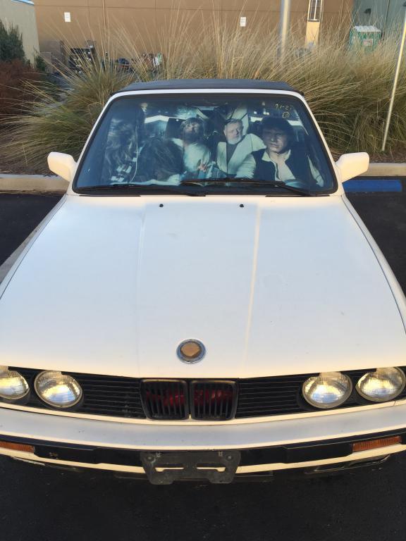

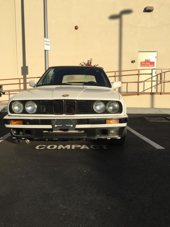

    so long story short my 1986 325 oil pan crack and I didn't want to do an engine swap. instead I bought a 1991 325i vert for ONLY $450
    super clean motor and super clean exterior... the interior was super bad, my parents, co workers, and my GF asked me if anyone had tried stealing it. LOL. the rear wheel bearings are humming really bad, its unbearably loud. and lastly its auto. :hitler:
