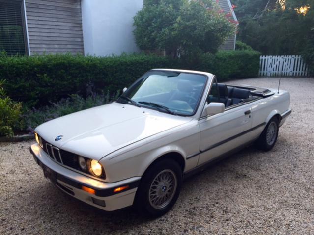

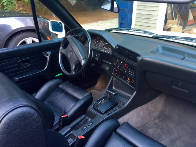

    Hi folks,
    I am the proud owner of a 1992 e30 325 Convertible, white over black, with 160k miles. Bought it from a wonderful little old lady who took fantastic care of it, gave me ALL the service records, etc. She never drove it in the cold, and always garaged it.
    I've done some work on it to get it completely up to snuff, and have encountered a few issues, hoping you all can help:
    -the OBC light display looked very feint, so I bought an LED conversion, installed it, and nothing changed. It's illuminated, but very, very feint, no where like it should be, and not even close to the radio's display. When I removed the old light bar, I could see there was some illumination, very feint, even without the light bar inserted. Inserting the new bar didn't improve it at all. Any ideas what it might be?
    -the heater core and associated plumbing was removed. Any comments on how tough an install that might be?
    -Radio code won't take. I did once, then I disconnected it another time and the code won't take. I've waited over an hour, driven around a bunch, and still it won't take. It beeps, but the display stays on CoDE, and entering it won't work. I've done all the research I can, here and elsewhere, and I'm still stumped.
    -Should there be a ping or chime or some sort of notification when the lights are left on, to remind me to shut them off?
    -When I close the doors, the window hits the convertible top, and sometimes I have to push the window in to get it to close all the way. Is there any quick fix to that?
    Thanks!

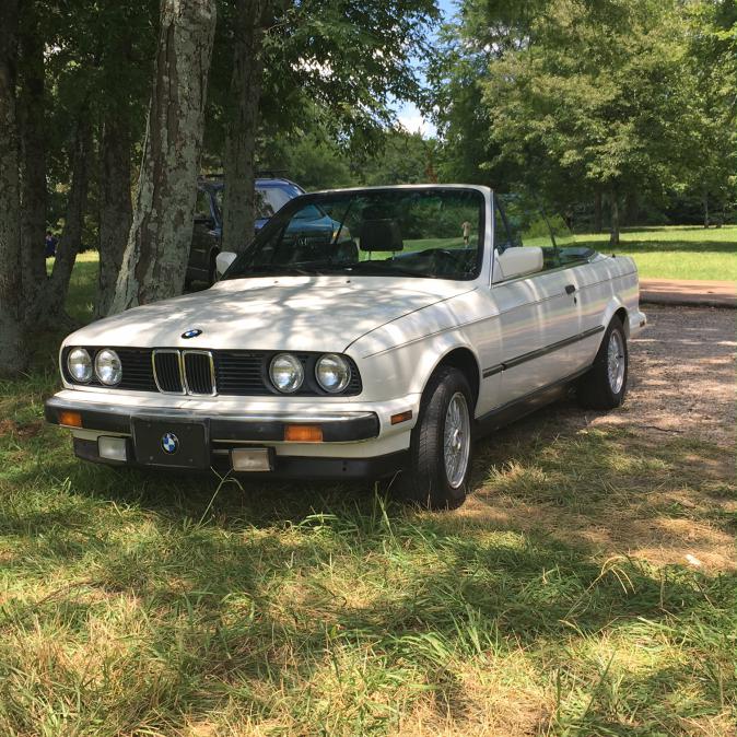

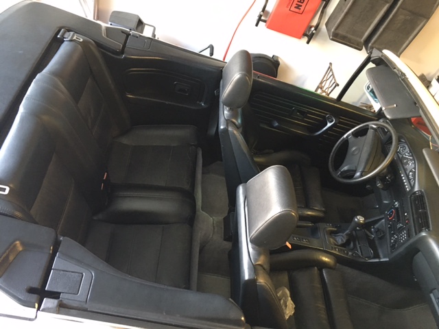

      Welcome. New-ish member here as well with a twin, except mine is a '91 w 125k and stick.
      (I'm jealous of your plastic bumpers)
