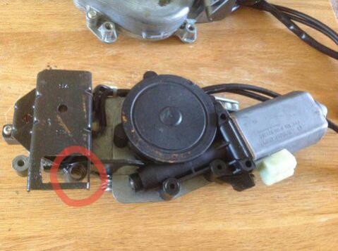

              Unlocking top cover?
              Been there done that..
              In my case the hinget bracket (see arrow in pic) was a bit bent. Later it broke completely, so the gears of the motor didn't fit anymore. This thing can't be weldet and is not a piece that can be ordered. Only the complete motor which is $1000.- over here. So I fixed the broken hinget bracket with liquid metal. Looks like sh!t but holds up for the next thousand years hahaaaaa. See second pic.
              Hope you get what I tried to explain, English isn't my first language.
              Feel free to ask, I'm happy to help.
