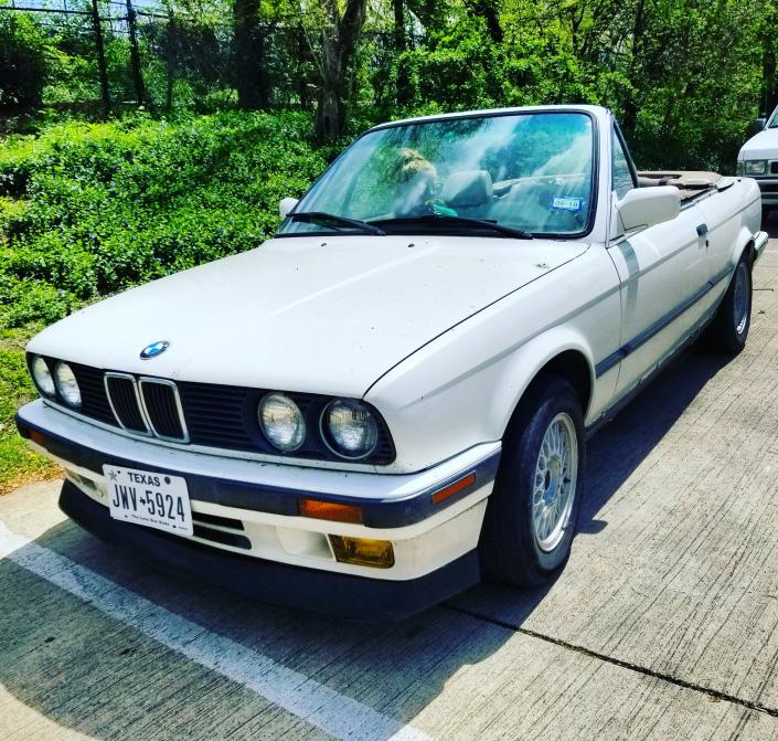

    Wide body kit for convertible?
    Is it possible for me to make the M3 kit like this one fit the convertible. Will there be a large gap at the top of the back quarter panels? I would like to make an M3 kit fit my convertible. What is the best route to get this look?

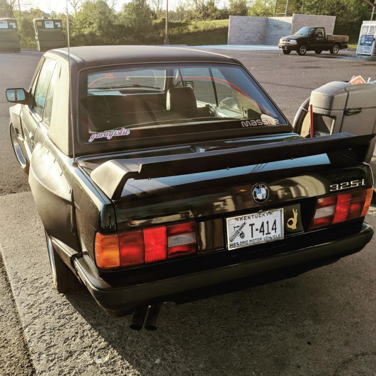

            It does fit :) Not as well as on a coupe though

              Nice! Did you have to modify the kit at all? Also, what size and offset wheels are you running with the kit?

                I didn't modify it, but the rocker panel piece doesn't line up as nice as it does on the coupe. Right now Im running style 5s (17") and Im waiting for my rears to be converted to 3 piece so they are wide enough to fit the fenders (they look silly currently).
