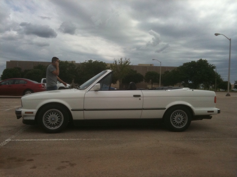

Eibach 'vert springs, billy sports, one rear spring pad removed, both front pads removed, e90 drop hats.
MT2 are just another flavor of an e30. Banning you is not nessesary. I personally like them alot and its hard for me to even think that this one is going to be for sale soon. Its just something about the Glacier that has me hooked!
You do have a nice stance but I would think that your overall ride would be lower. Maybe its your 14"ers. It may need to settle if its a new suspension.

I recently purchased an Mtech vert (white/white/white) and am looking into suspension. My car is just the appearance package (no mtech seat inserts but the full, original kit,etc...)
Does anyone know if I have different springs than stock verts? The car appears lower but I have not taken them out to measure, etc... If they are different, are they just lower (-20mm as suggested above which would make sense)? Are the spring rates different? Do they compare to anything aftermarket or are they similar to e30 M3 in drop and stiffness?
Should I just thrown on some Billy Sports and be done with it?
Thanks!
