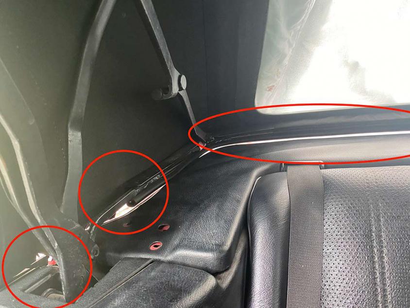

    Hi,
    I purchased a convertible, the previous owner made it clear that the top needed adjustment. When I checked the rear part of the convertible top, I noticed a few bolts are missing. I plan on taking a couple of the bolts to the nearest hardware store to try my luck. However, wanted to check here if you believe those nuts/bolts will help reduce the gap on the rear of the convertible top, if not what will?. I can basically look straight outside (see attached).
Name:	convertible top forum.jpg
  • Shangsta
    • 1485
    Its mostly likely someone replaced the top and didnt do the correct amount of shims under the top frame mounts. The shims can be seen in this video [YOUTUBE]rHP1oI1R38/[YOUTUBE]. If you want to understand how it all works for to the guys play list and there are 3 videos, this is the second of 3.
