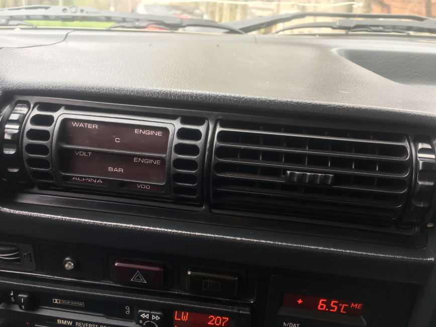

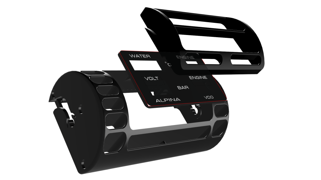

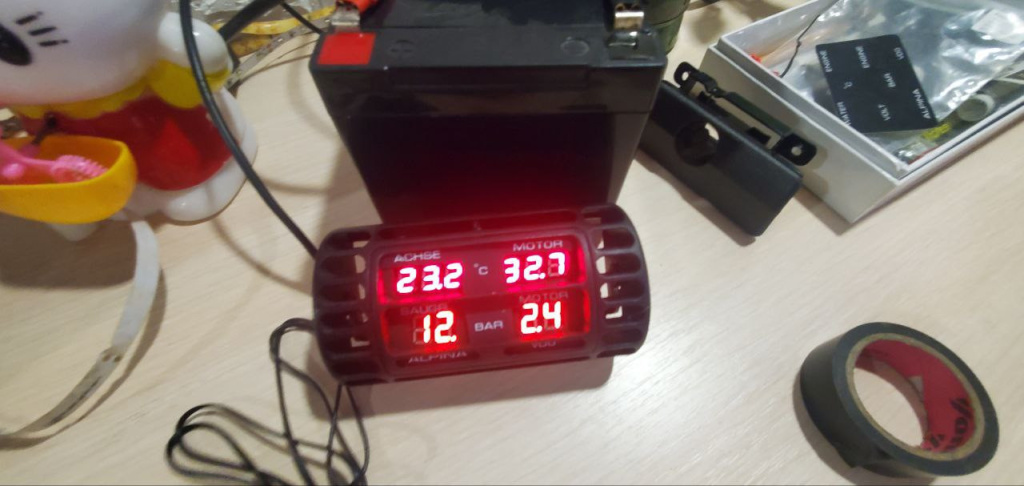

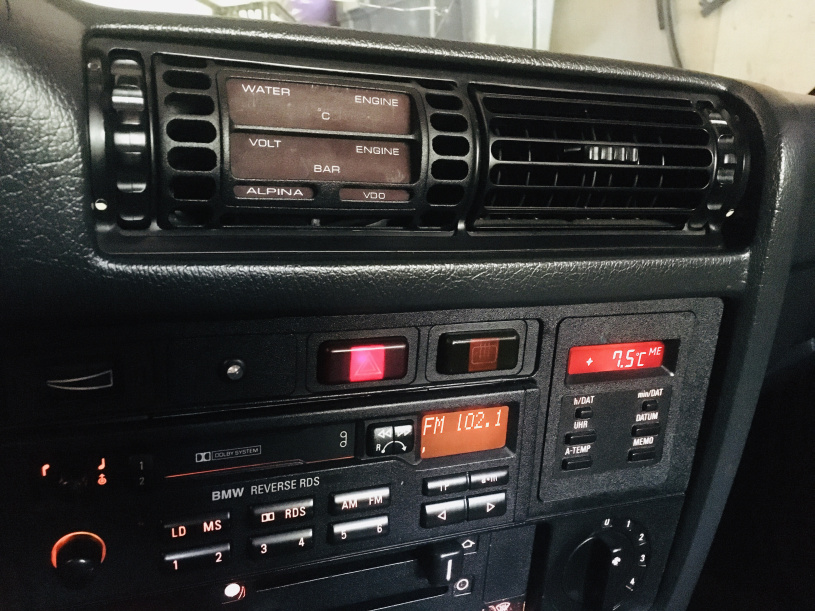

    Alpina VDO central gauge pod
    OEM-number: -
    Click image for larger version  Name:	IMG_0544.jpg Views:	0 Size:	198.6 KB ID:	10097037
    Download link: https://cults3d.com/en/3d-model/gadg...ral-gauges-pod
    Description:
    Aplina VDO center diffusor gauges pod. There is no OEM-number for this part.
    Perfectly fits in place of one of the center air diffusers.
    Modelled with the original air diffusor dimensions, and its mounting shapes.​

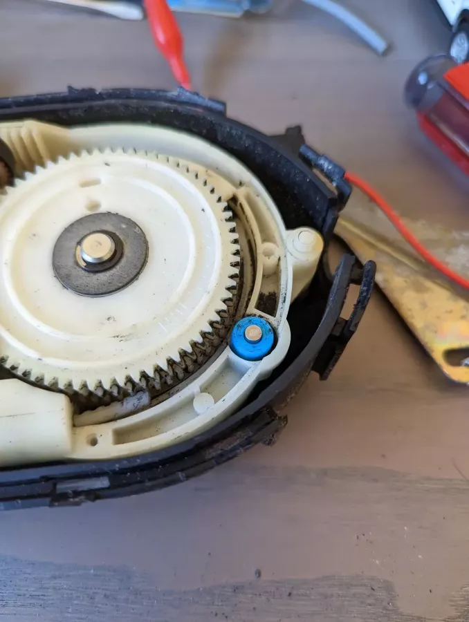

                I have a few models to share:
                E30 Power Antenna roller

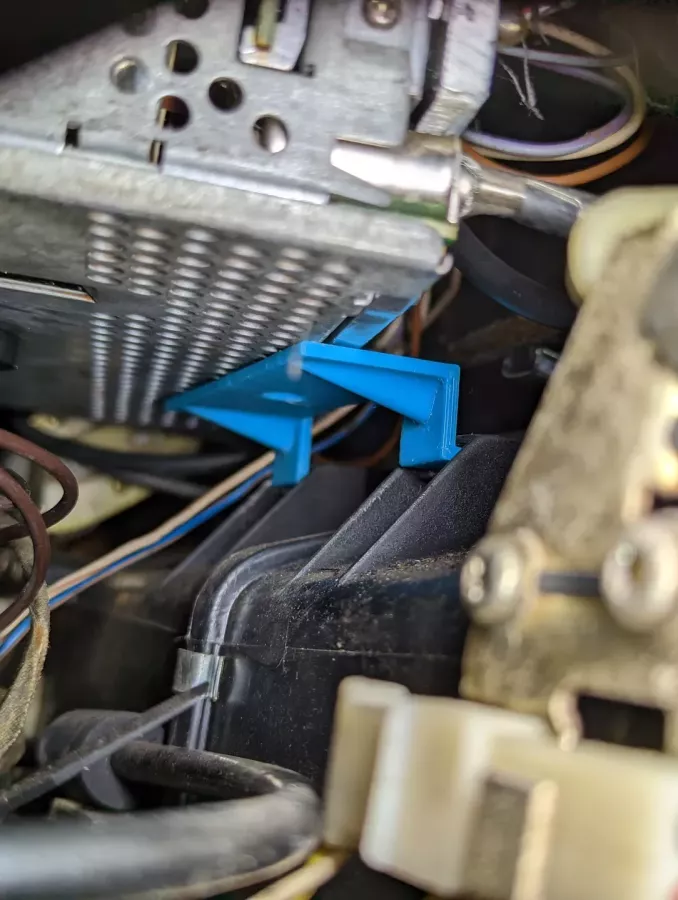

                E30 Radio Support Bracket 65111370841

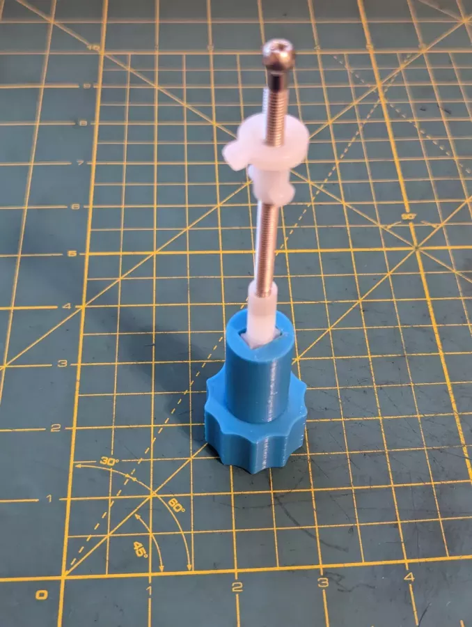

                E30/E24 US Ellipsoid headlight adjustment knob

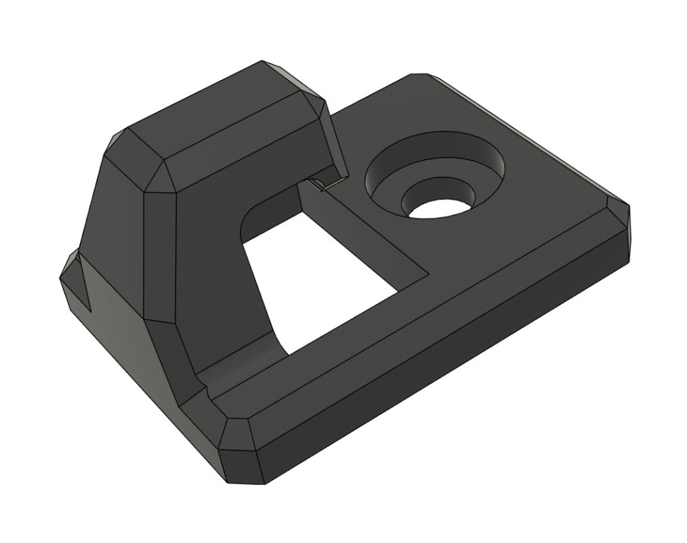

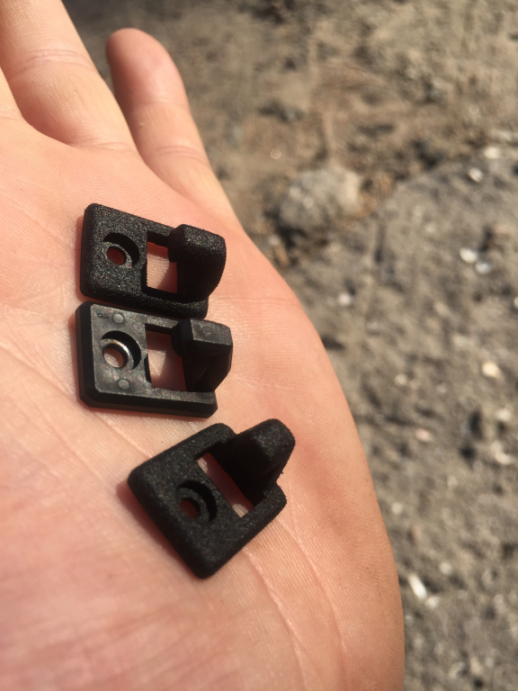

                  Rear sun shade roof hook (probably, before 09.85)
                  OEM-number: 82 12 9 413 178
                  Click image for larger version  Name:	2023-08-02_1-51-34.jpg Views:	0 Size:	77.5 KB ID:	10100765
                  Download link: https://cults3d.com/en/3d-model/gadg...2-12-9-413-178
                  Description:
                  For E30, E28 and maybe some other models.
                  Reproduced from the dimensions of original part.

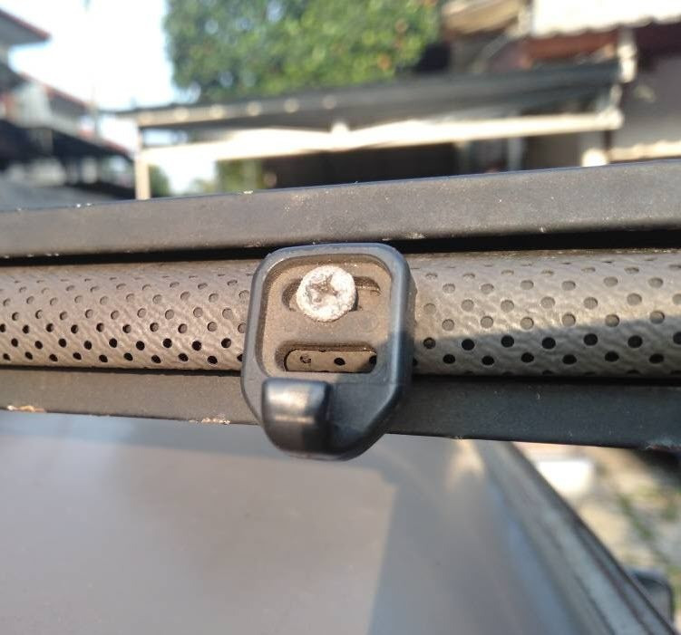

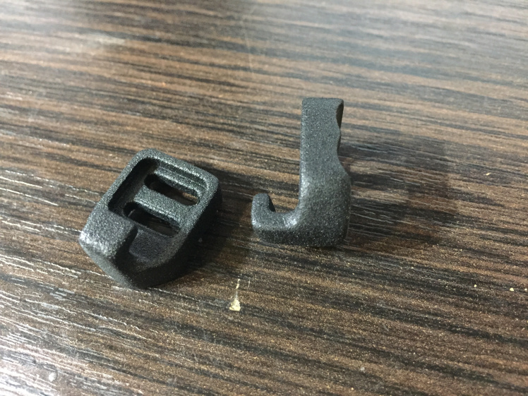

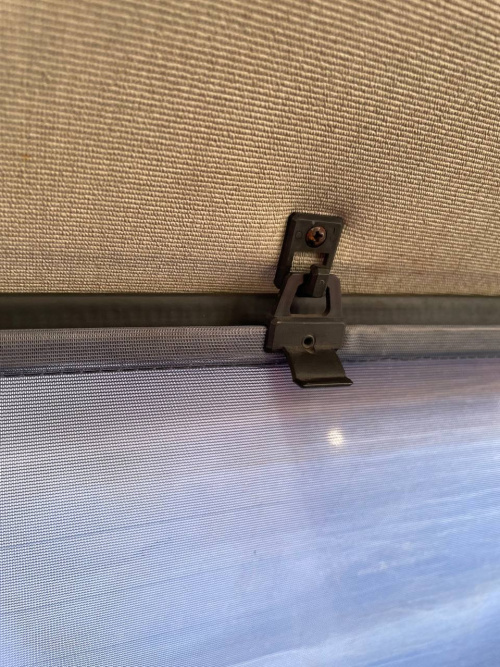

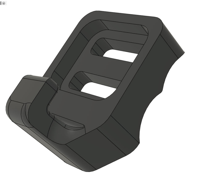

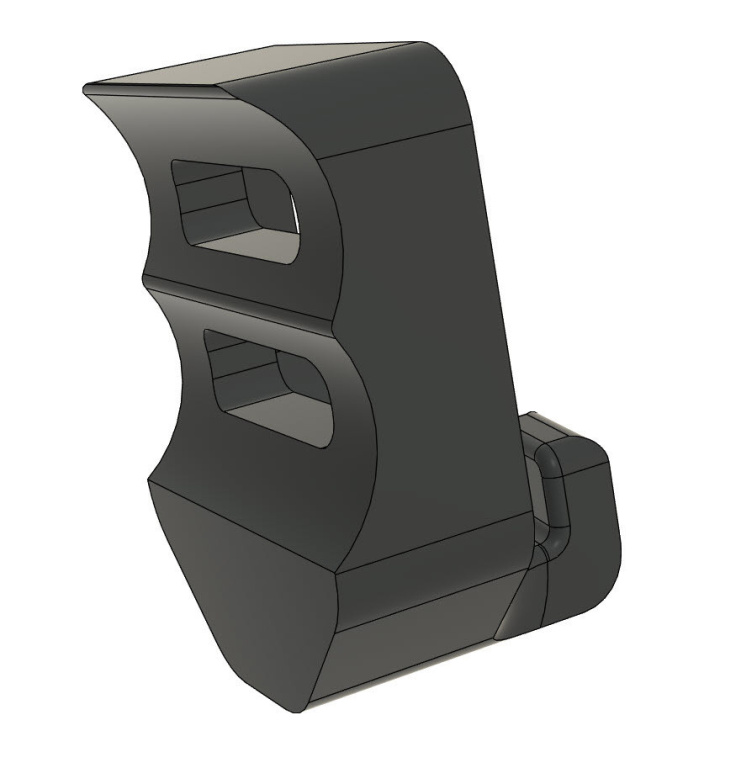

                      Rear sun shade hook (probably, from 09.85)
                      OEM-number: 82 12 9 413 178 (might be wrong)
                      Click image for larger version  Name:	IMG_0723.jpg Views:	0 Size:	241.2 KB ID:	10103587
                      Download link: https://cults3d.com/en/3d-model/gadg...sun-shade-hook
                      Description:
                      For E30 (maybe also E28\E21\E23\E24)... In case of E30, this hooks might be for models produced from 09.85 (when rear shelf was redesigned).

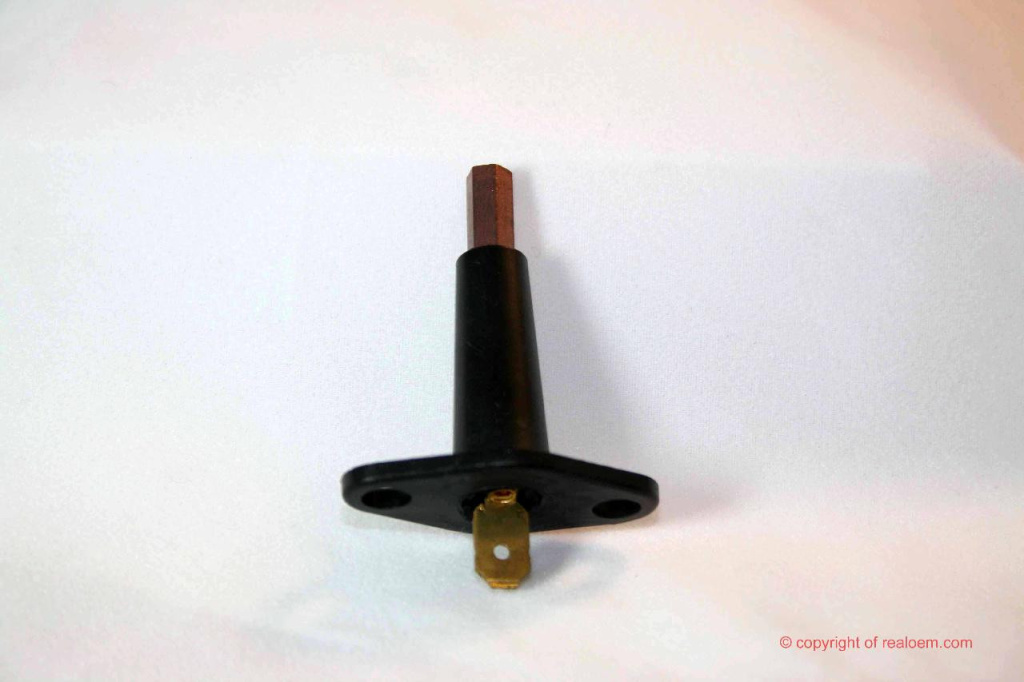

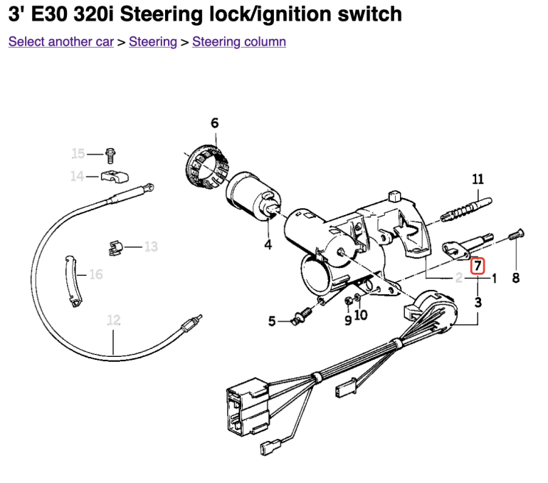

                          Can you make one for the NLA horn carbon pin:
                          07 Carbon pin 1 32331350750 $7.64 ENDED
                          The plastic housing always breaks. I should have ordered a few last time but now they are NLA. Mine is cracked but the pin and spring are fine.

                            Hello
                            There is already this part modelled: https://cults3d.com/en/3d-model/tool...contact-switch
                            But honeslty, i think it's author OVERpriced it, for such a simple shapes...
                            If its ok to you, you can try it. There is refund possibility, if something goes wrong or the model is bad.
                            p.s. i can't recommend this model or author, i did not try this model.
