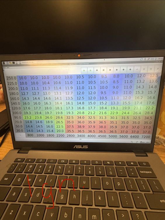

    Ignition Timing

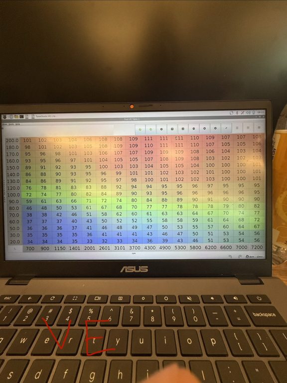

    VE

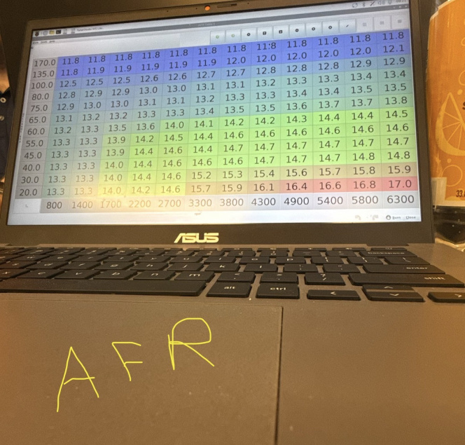

    AFR table

    Hey, I’m still figuring things out on my setup aswell. What I’ve been doing is doing safe pulls with overboost cut out ON and set to 160kpa any boost over that the fuel will cut and save your motor from too much boost until you figure out if your too lean.
    if your going for 6-8 psi lower your fuel table to 160kpa which should be 8psi or so for better resolution between load.
    next thing is your fueling seems really lean rpm2600 - 6500 my numbers from 100kpa to 160kpa range from about 100 to 135 and I’m planning on adding more cause my AFR is lean.
