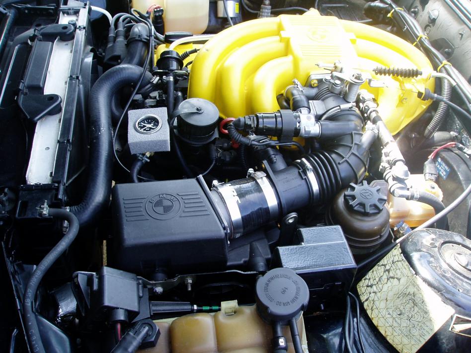

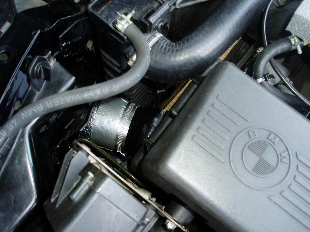

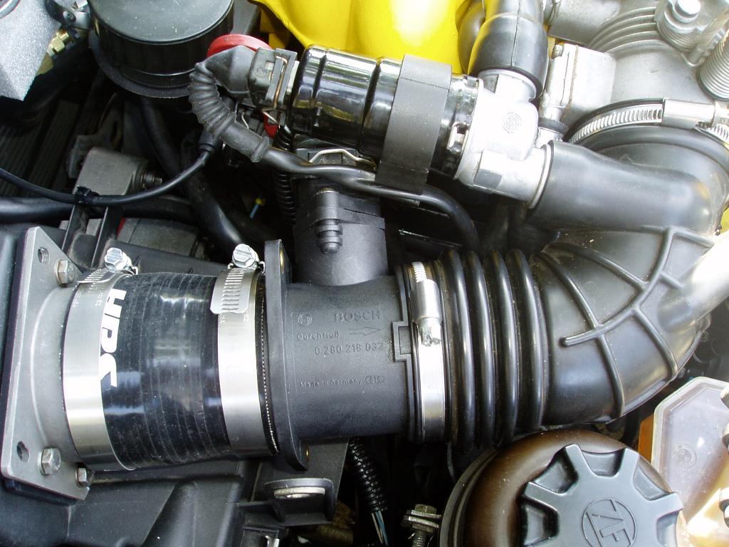

                          Using OEM AFM with Miller MAF
                          Here is my system using the OEM AFM as you can see the box can return to its original use since I did not modify it. I also used the flat stock filter. I 'm going to try a foam filter with no oil submersed into it. I also left the plastic cone in the top of the box that I may remove. Car pulls well, I changed my idle by two hundred RPM to idle at 900 rpm, I think with the foam filter and removing the cone I will be closer to the car running better out of first gear. I'm doing A lot of trial and error with small changes and using common sense.
                          Update removed water hoses to the Throttle body as this heats the throttle body, just join hose together with a tupe coupler. Want to think cool..
                          Enjoy

                              Your set up is beautiful honestly its really clean elegant and kinda looks like a Motorsport set up to me. well done man.:up:
