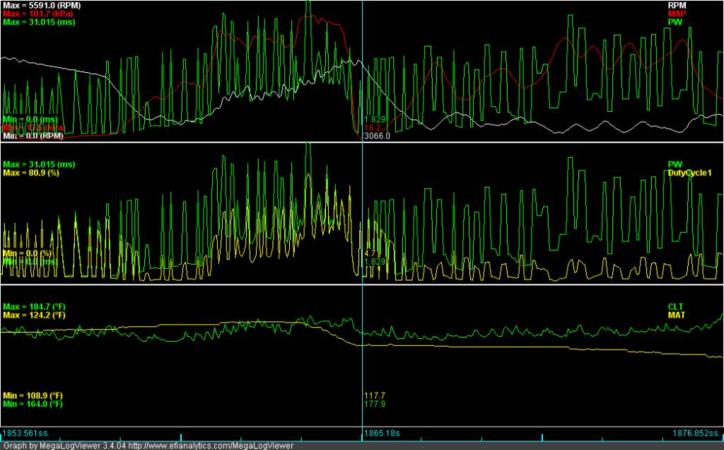

    Hey guys, I'm hoping to get some help with my MS2 issue. Occasionally the car runs really poorly, almost like the rev limiter is on, spitting and sputering, and lots of surging, but it kinda clears up 3500+ and sometimes it just runs great (most of the time). Idle is lower and more erratic when the problem is occuring, and it threatens to stall at stop lights. Running MS2extra 3.3.2, bone stock m20, and as bare bones as it gets: stock narrowband, stock afm iat sensor, stock clt sensor, disconnected the tps because no variable tps yet, and a tune that essentially replicates a stock ecu. Wiring is spliced into stock ECU wires so I could plug the ecu back in if this stuff didn't work.
    When the problem is happening, the pulse width goes insane, all over from normal around 5 ms to over 25 ms at times. that's the only thing I've been able to notice.
    Here's a section of data log when it happened:
    Hopefully I've got semi enough info to get the message across, please let me know if there's other stuff I could include to help explain this confusing problem. I'm not so sure what I'm doing wrong, and if someone could please help I'd really appreciate it. I can explain the problem more but I'm assuming the data logs are more informative than me trying to explain it.....

    Okay well sorry to waste everyone's forum space and time if you read through that, but I thought a little harder, and my tiny brain figured it out. So I set the accel enrichment to 100% map based (it had been 100% tps based) because I don't have a tps hooked up. I had always noticed the tps gauge on Tuner Studios would just freak out, anywhere from -1,600% tps to 2,500% tps (WTF!?!?) so I had closed the gauge out because it was annoying to look at. I noticed everytime my problem occured it was as soon as the tps sensor started flipping out. So now it's MAP based and boom problem solved!
