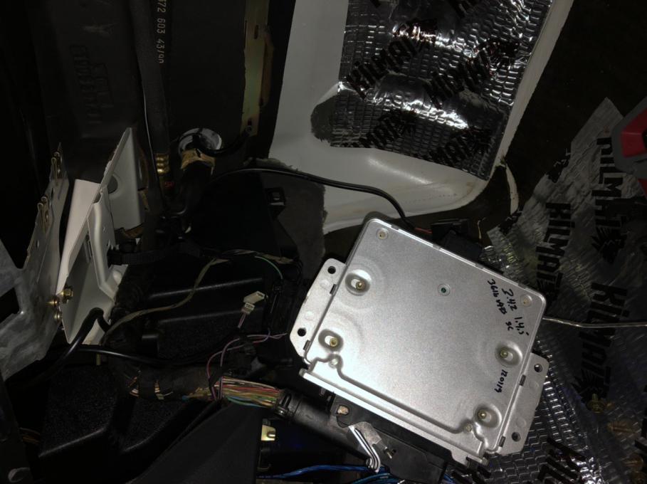

    Some how I’m getting wrecked off the bat with my MS install. I have a MS2 from whodwho, everything hooked up, map is installed, connected to the harness and it’s waiting to be tuned. I connect it to my laptop and try to start a new project and detect device. Get an error message that it can’t find it. Video here https://imgur.com/a/7yKFuoV .
    I deleted and reinstalled the USB and I get com3 at 115200.
    So I’ve updated drivers, googled and looked online for solutions etc. nothings working, so I want to verify I’ve done everything correctly... I’m using the DIY adapter for 9pin to USB. MAP connector is just chilling in the pic but is connected now.
