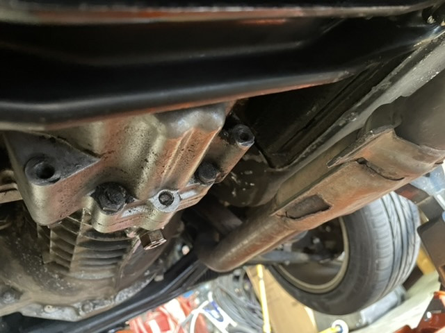

    b25 mid pipe hanger?
    Hey guys, my car was originally an eta car that was swapped long before my ownership to a b25. There appears to be an exhaust hanger right at the back of the transmission that is missing. Researching I’ve come up with a few different items that may or may not be what I need. Can anyone show me a picture of what I’m supposed to have here?

  • treystoys
    • Jun 2022
    • 30
    Figured I’d answer my own post. Im assuming because my car originally had an eta in it, the hanger I thought I needed was probably not correct, but I ordered it anyway. It was very close, but did not line up. I simply re-drilled it to shift the arm about an inch over to the drivers side and it works perfect.
