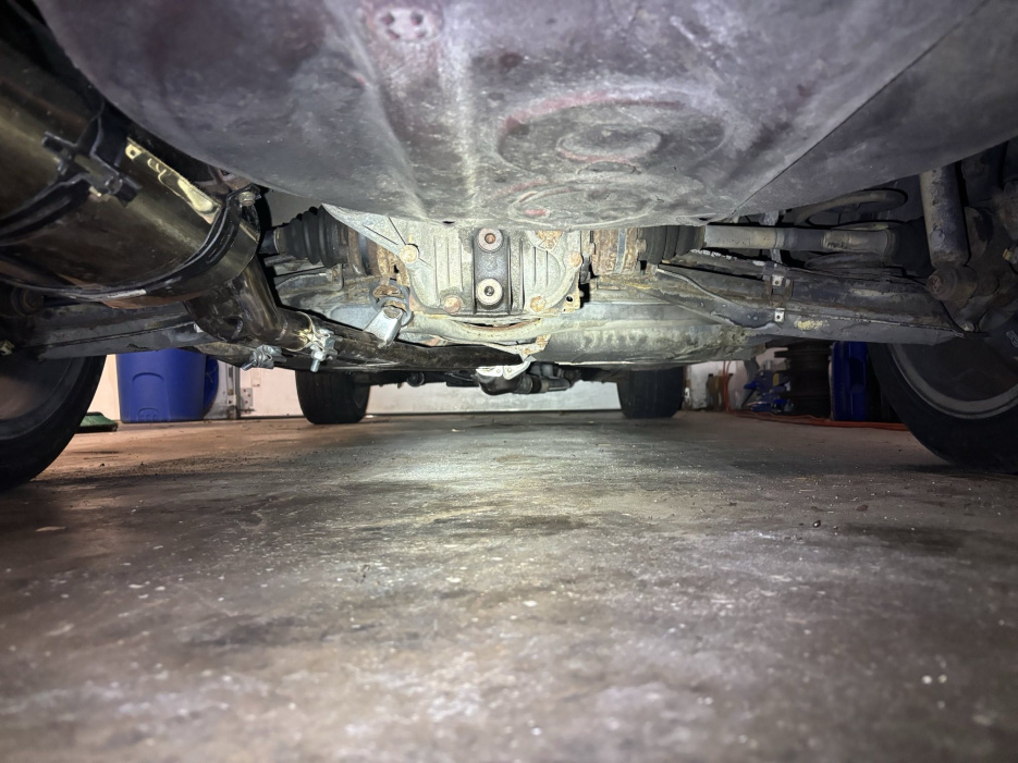

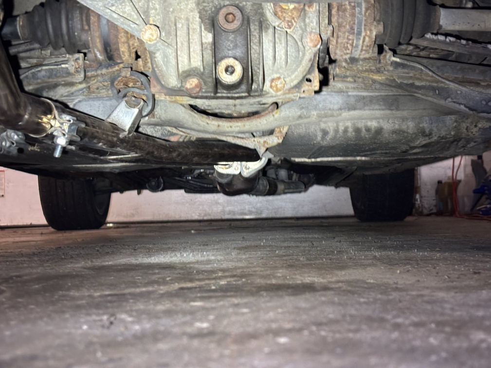

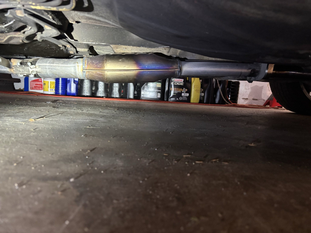

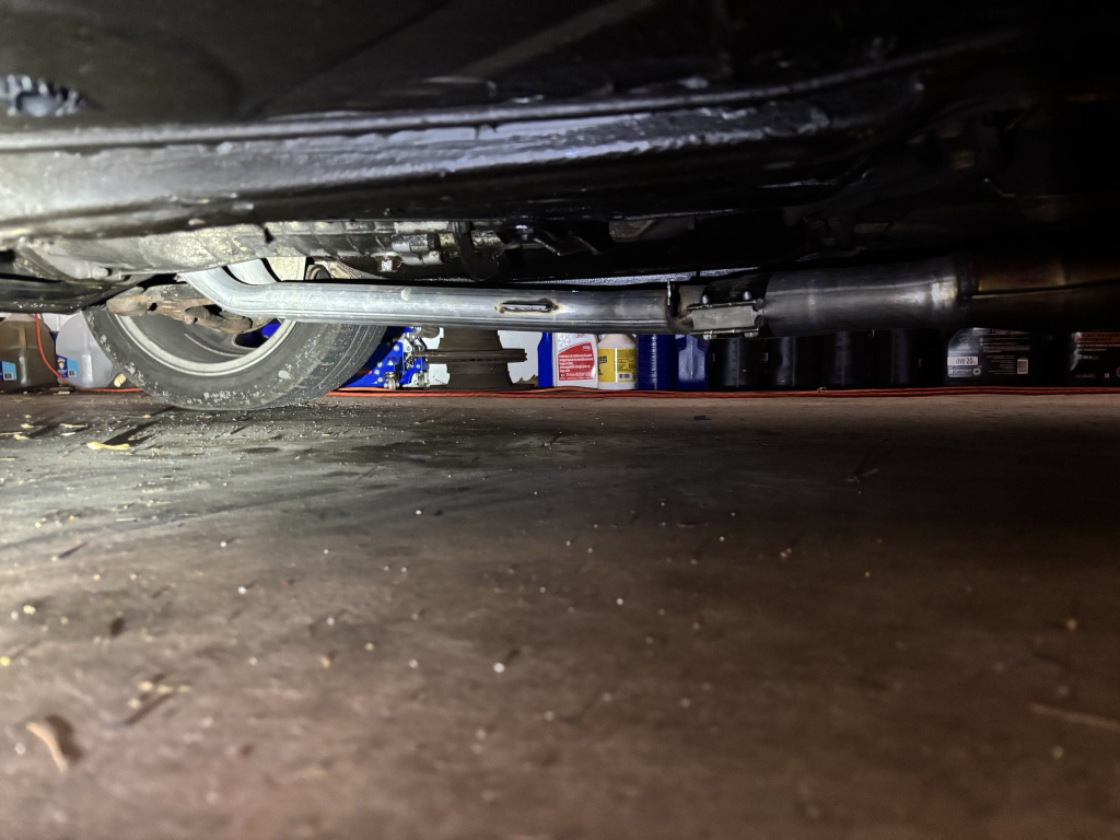

                    Hey sorry all, totally forgot about this. It works, but I'm not thrilled with the fitment. The downpipes are probably a little too long, the bend could be a little more, and the cat is welded at a slight angle. I don't know of a better option and I plan to stay at stock ride height so I'm keeping it. Here's a few photos from level, sorry they're not great but hopefully they help.
