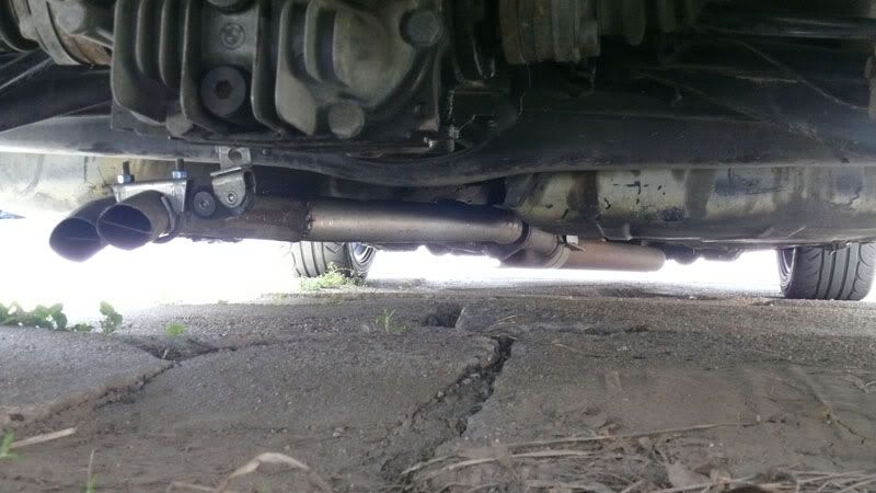

                      Just do this....
                      Basically a couple 45ish bends and turn downs.
