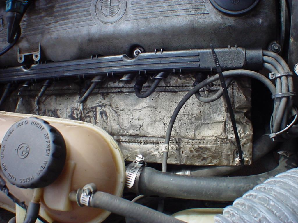

        how important are the heat shields?
          If you cut the heat shields, get ceramic boots on your spark plug wires so they don't burn up.

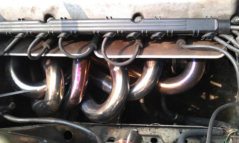

                      Finally got my header and exhaust installed.
                      The cheap header actually fit better than I expected. I ditched the mid x pipe since I am using 2.5" single piping.
                      Installer had some issue getting them to fit, but no modification required for front section.
                      Installed

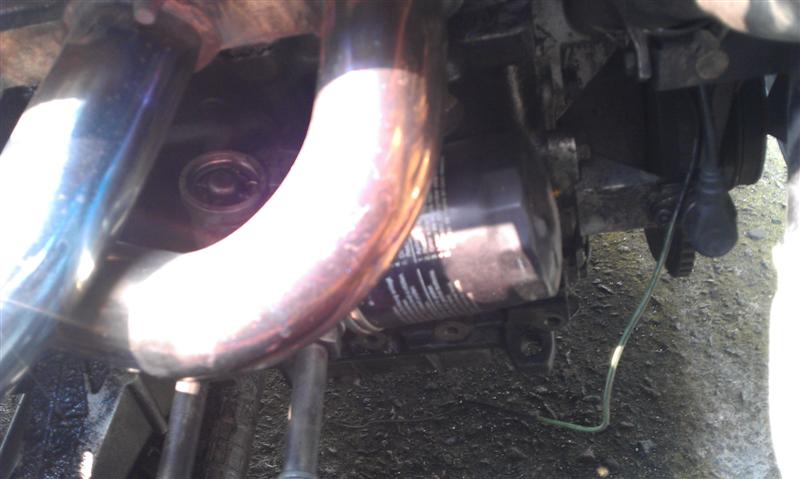

                      Later when I was doing oil change, I couldn't get oil filter off. Fortunately, I didn't have AC system, so clock the oil cooler adapter fixed the issue.
