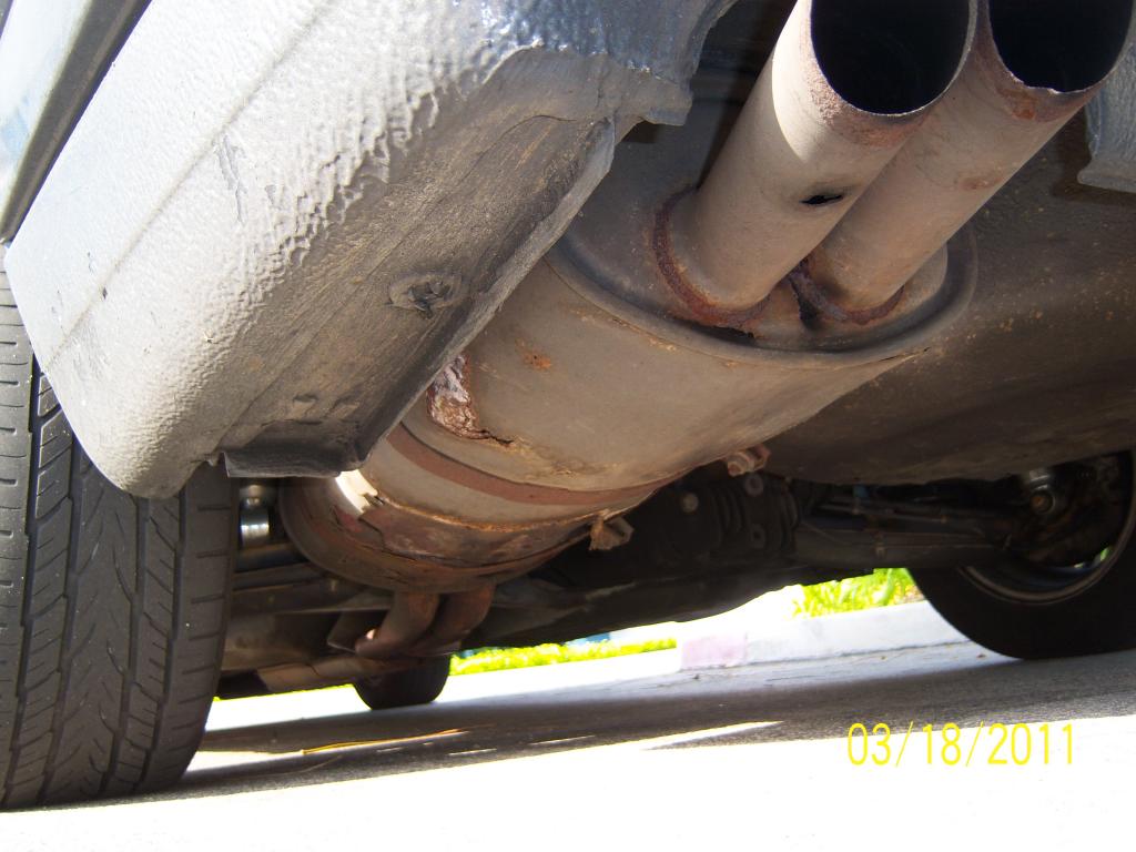

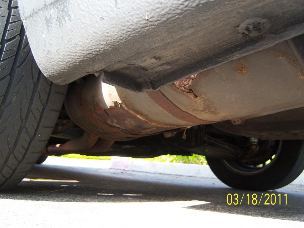

    OK so I'm on the ground checking out all the sweet hole in my muffler when I relized that if i hit a bump hard enough that it will come apart faster than a M20 oilpan...
    Damn.. it's too bad I realy like how it sounds right now.. oh well..

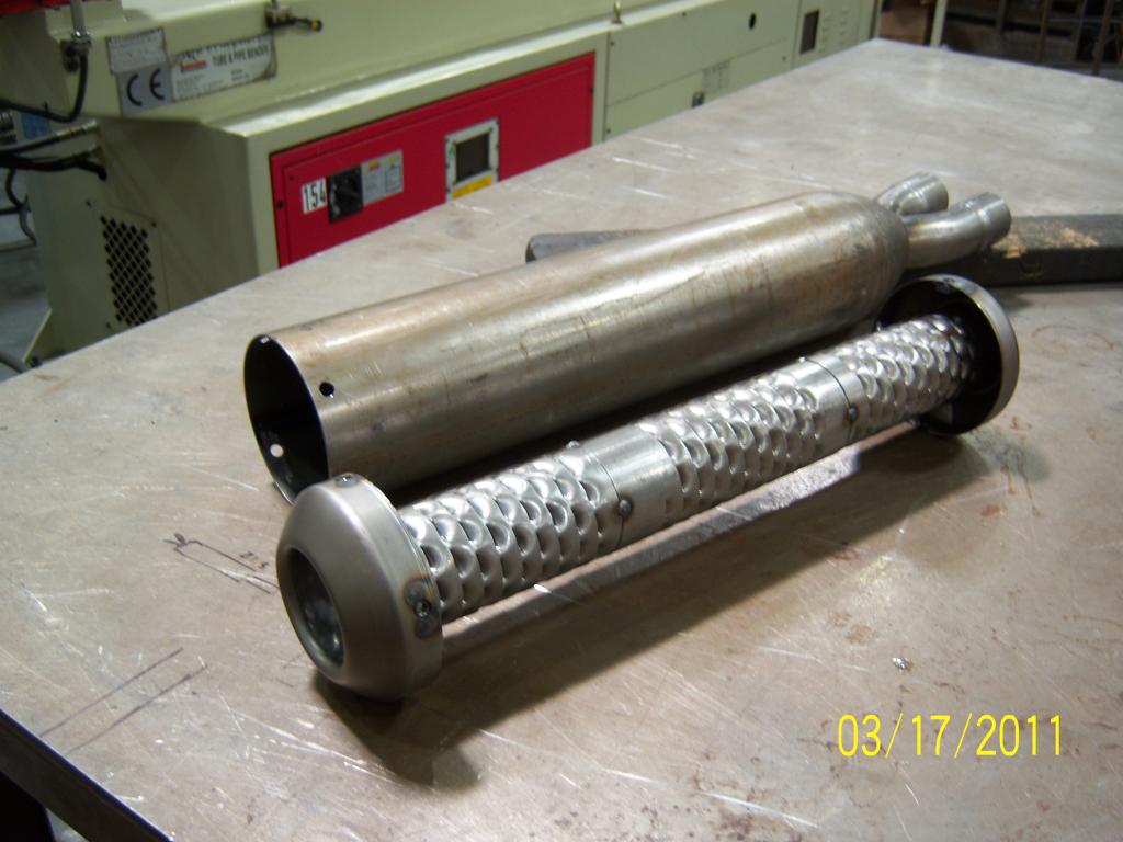

    So I'm a fab guy by trade, but i get paid to build exhaust for motorcycles for a living..
    So I read some where that glass packs fucking rock on the tail end of the m20..

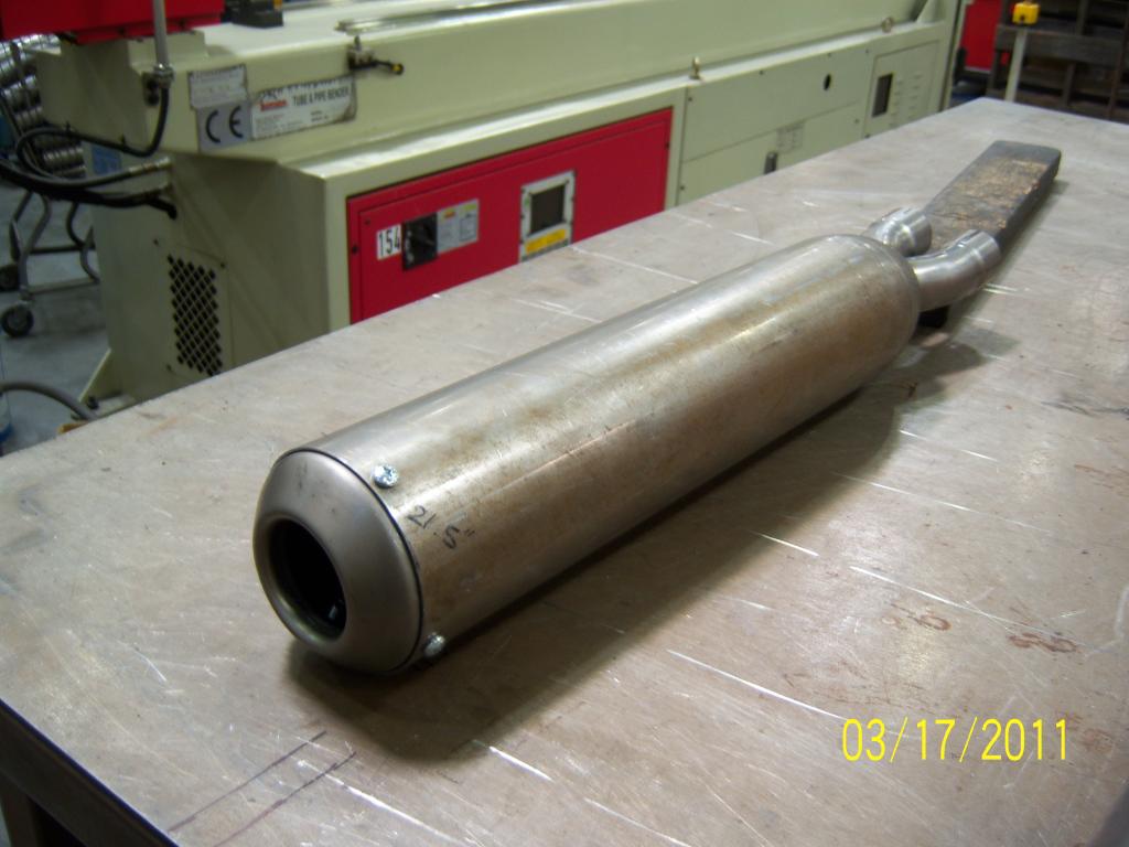

    1. Ok fisrt of three is a big ass fartcan size 2-1.
    4.5" x 21.5" long body w/ 2-1 collector running 1.75" to 2.5 butt

    Core is 2.5" x 19" louvered core body removeable and repackable

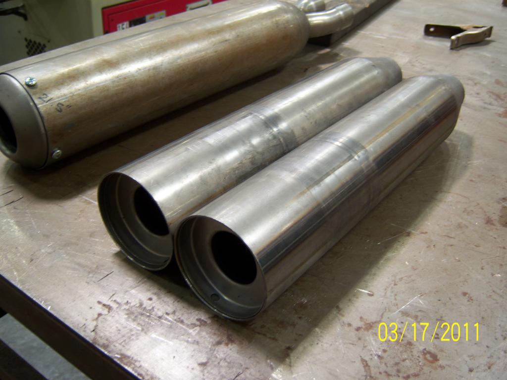

    2. This set is a pair build, of 3.75" x 19.75" long bodies
    Cores are 2" x 17" louvered core body removeable and repackable

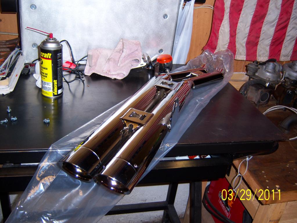

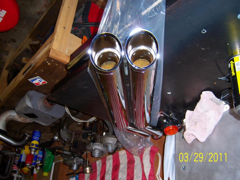

        Just finished a fully welded set, and sent it out for plating today..
        I changed up my look
        I'm running duel 3" glasspack style bodies, 21" long with a fully louverd 2" core
        packed with tempered/pressed fiberglass packing..
        As for the tips, I have 2 buillet tips cnc'ed here, in a euro style slash cut look
        they'll extend out about 2.5 inches from the valance edge.
        These are fully repackable, and I carry the fiberglass (bun) inhouse.

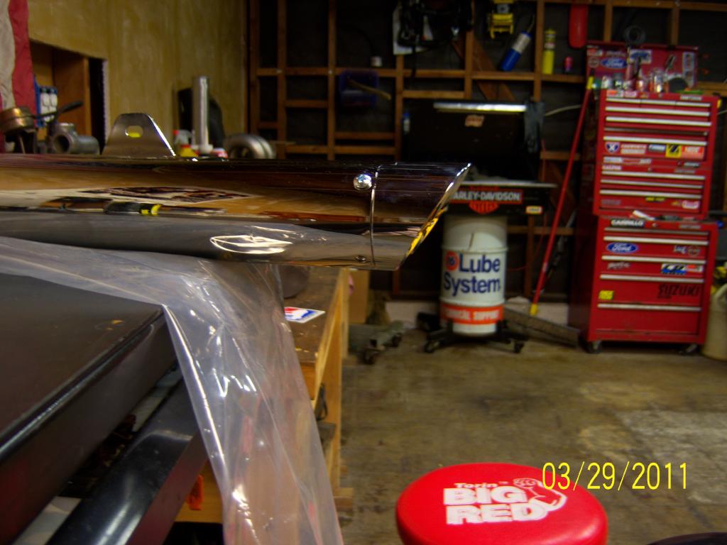

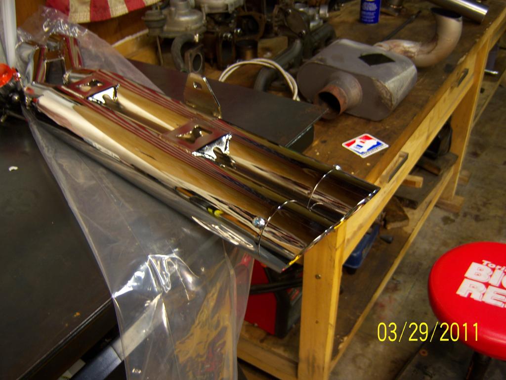

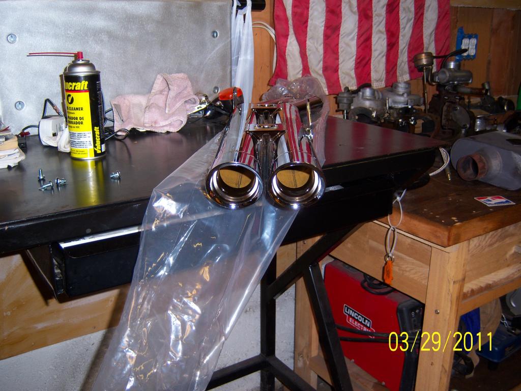

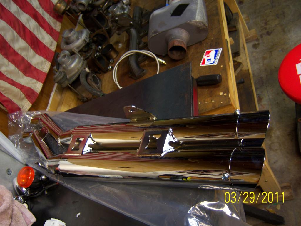

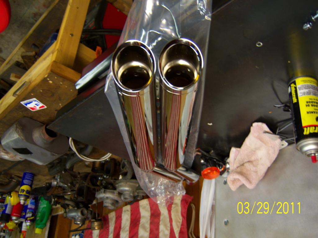

                      Ok so got my muffler and tips back from the plater..
                      All excited, Left work early to pick up the kid and forgot to bring home the
                      mounting brakets, cores, and fiberglass packing (bun)

                        more to come when I remember to bring home the core's
