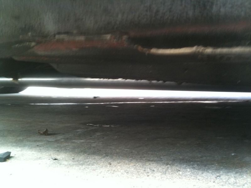

    heres a pic to give you an idea of clearance, its a pretty good fit doesnt rub, but I havent really driven the car anywhere or over speed bumps, so I want to keep clearance the same orsimilar.
    my setup CT-26 turbo, 2.5-3" DP to 3" pipe all the way back.

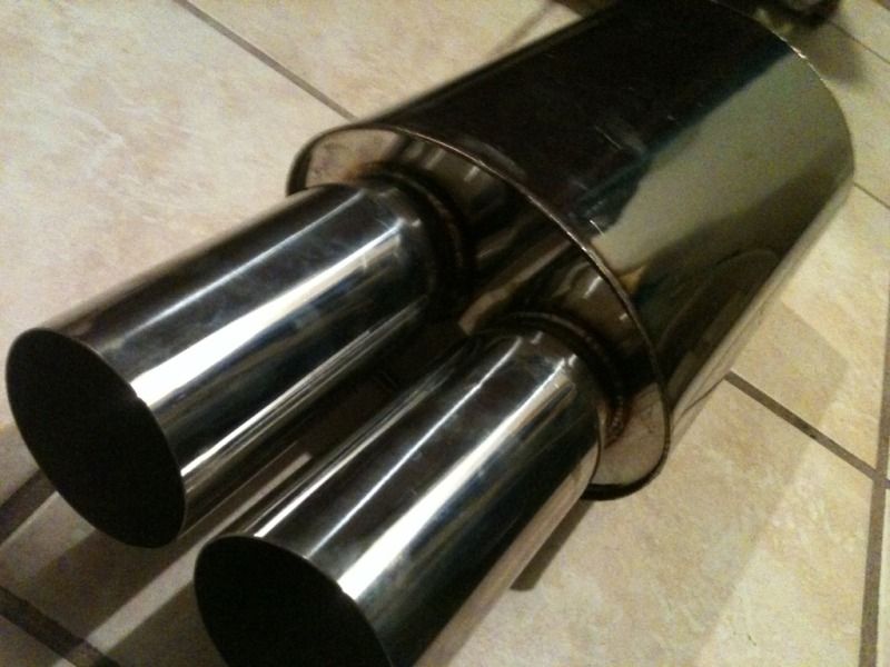

    Im considering selling my muffler and finding something else but this is what I have its not on the car yet:
    Im thinking maybe a resonator or cherrybomb style straight muffler before the tip, but will this be enough? any experience with this. On my mkiii supra I just kept the straight pipe with straight muffler, but at that time I could care less because it was a 3.0L and was pretty quiet as is and there were a sh*t ton more bends than the e30's exhaust system.

    I've got a 3" on my m20 turbo too. I have a "turbo muffler" from summit and a glasspack from summit. It's really not that loud. I was expecting it to be wayyy louder.

        I have 3" straight to a Magnaflow in the back. No center muffler. I consider my car to be fairly quiet.
          any part numbers on that magnaflow muffler?
          also is it a straight through design?
          • MR 325
            • 37833
            I actually don't know the number on it but yes it's a straight through.
            Grover Beach, California
            BimmerHeads.com
            • dmjensen
              • Jan 2011
              • 805
              i have the same muffler as you do op, except i have a full 2.5in exhaust. and it was fairly quiet
