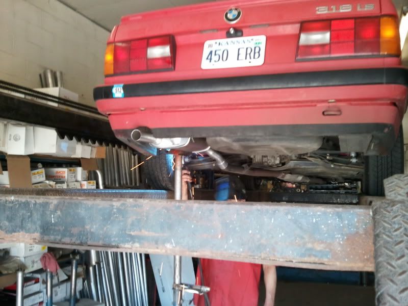

    I just had a Dynomax Super Turbo 17731 welded on, my stock muffler had rusted completely free of the rest of the exhaust. Cheap, quiet, and sounds good. Can't vouch for any performance increase though, as I never drove the car with the stock muffler actually in place. Was $46 on amazon with free shipping.
