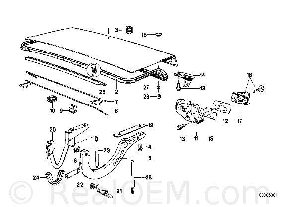

            Yes! that same rubber, part 51711884149 "trunk lid seal".
            We're struggling to get original parts here in Argentina, so I had to search for an alternative. I went to a shop (something like Autozone for you) Norauto, and bought an "universal trunk lid seal" came 4.5 mts and was really cheap. The profile of the rubber is the exact same one of the BMW OEM replacement... but 10 times cheaper.

            Hi Andrew, yes! That rubber strip was all frayed and dry. After replacing that trunk gasket lid the exhaust fumes dissapeared. I can drive for 20 miles without having to take a bath! hahahahah

            Part #2 in RealOEM diagram (applies to all BMW E30 I think)
            Part No. for mi 325: 51711884149
