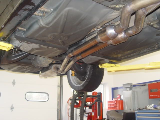

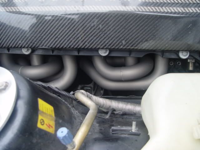

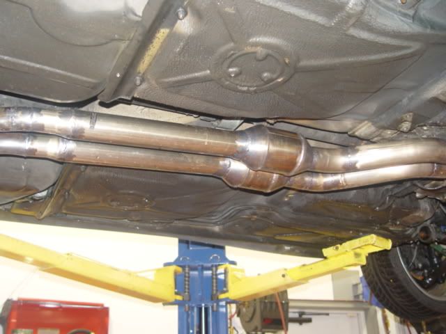

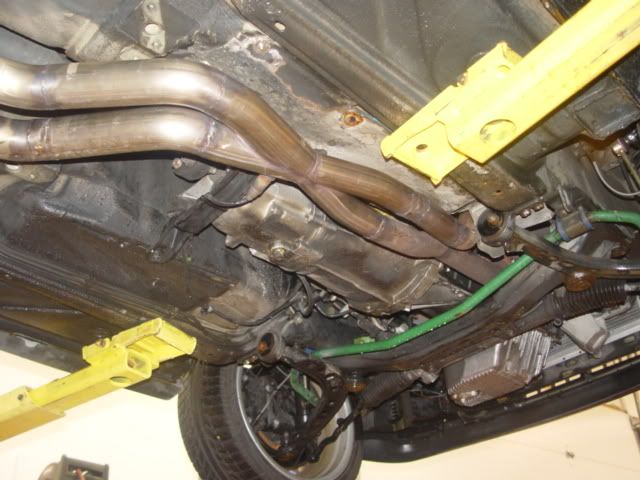

    I bought a set from Turner Mo'Sport. The company that makes them for Turner does an e30s5X set of rear headers that will clear everything just fine. You just need to tell Kevin or Dave at Turner that you have an e30s5X, and they can make it happen. They're not cheap (at $900), but they look great, sound great, and even better, make some decent power. I got 10hp, and 15lb/ft from just the headers alone (dynoed before and after install), but I'm sure it's more now from the other exhaust work. You might see less power than mine if your motor is stock, as mine is completely built. Here are some shots of the headers/exhaust system on my car:

              not a bad system, im impressed. what size is that diameter piping? seems a tad bit on the big side but i do like the X-pipe alot. I may be mistaken but is the whole system welded? if so what are you gonna do if you ever need to do work downthere? im hoping u dont plan on taking off headers each time.
