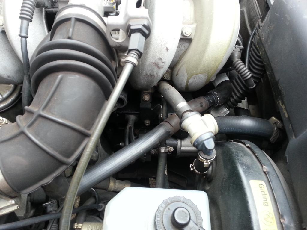

    yeah I went to the parts store and got to scramble thru their wall of hoses. It costs more than the BMW dealer oem part. Might be because of the funky bends. I ordered that hose from the dealer for $8. I might still try to find a 90deg hose and do it direct like you said. it is 5/8" at the ICV and 1/2" at the other end.
      So I did the direct connect with new hose i bought that had similar bends coming off the ICV. I used a new 5/8" hose and got a reducer connector to transition to the 1/2" hose to intake boot. Connections are tight. Clamps were not needed as the connectors are the ribbed type. I can add them later. Right off the bat I noticed my idle at cold startup is steady. No jumping around searching for RPMs. Did several more hot startups and it's steady. Next step is the O2 sensor.
