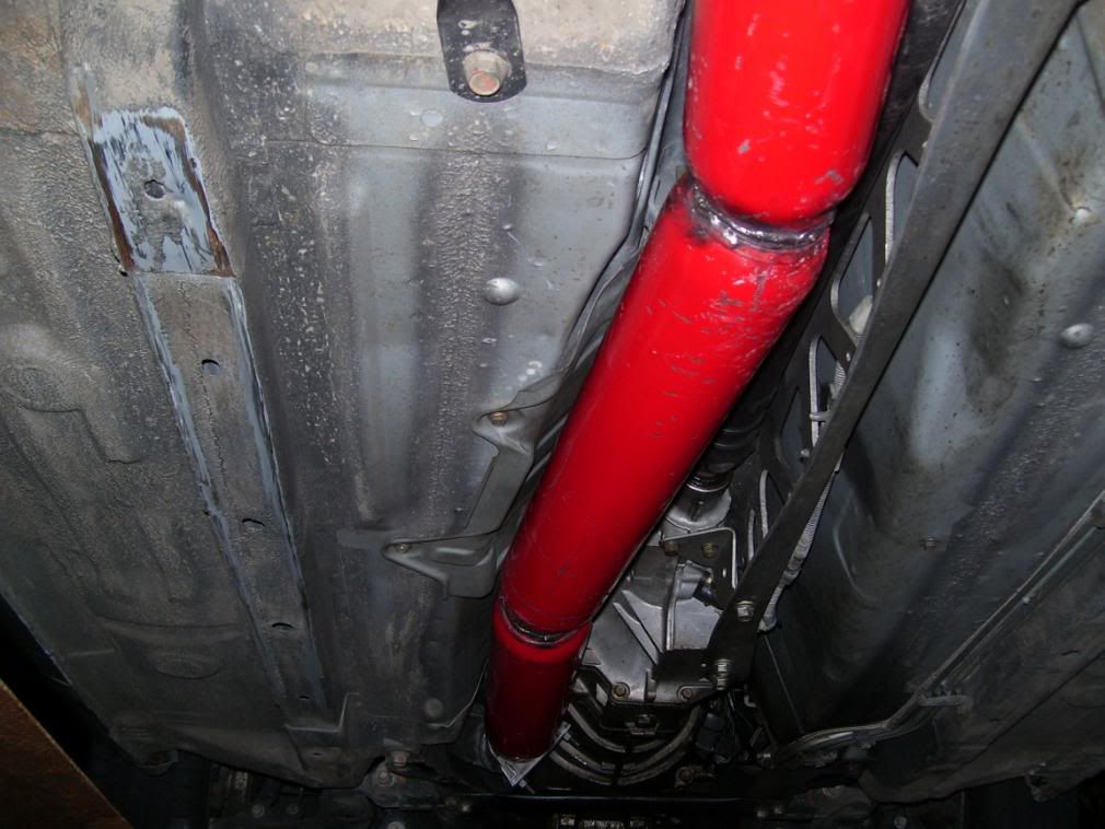

          • LowR3V'in
            • 4209
            This 23'' (I think) magnaflow.
            Biggest muffler that fits in the back. Sounds GREAT.
            There was a 18'' flowmaster 40 before. Was too loud and ricey.
            I imagine a 14'' would sound like hot, wet, garbage covered in honda civic.
            Also use a canister style muffler in the middle.
            Sounds like buttery sex and is very enjoyable.

                Instead of exhaust pipes just daisy chain mufflers. BAM Quiet.

                • LowR3V'in
                  • 4209
                  • bmwguy325is
                    • May 2011
                    • 1263
                    ^---------THIS!
                    sigpic"If one does not fail at times, then one has not challenged himself." -Ferdinand Porsche
                    The ugly car: http://www.r3vlimited.com/board/showthread.php?t=209713
                    • fronton
                      • Oct 2009
                      • 1262
                      Originally posted by LowR3V'in
                      hahah, what does that thing weight?
