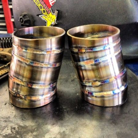

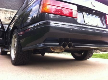

    Problem solved. Flex pipe > Magnaflow cat > Vibrant UQ resonator to 18x8x5 magnaflow with lots of pie cuts for the dual 2.5" out to fit the M3 bumper.

            Looks like I am going with the 8x5x18 3" in/out magnaflow. Hopefully the extra 4" of length will be a little quieter than my current 14" 3" in, dual 2.5" out. I am adding a 3" flex pipe as well which may lessen vibration at idle.
