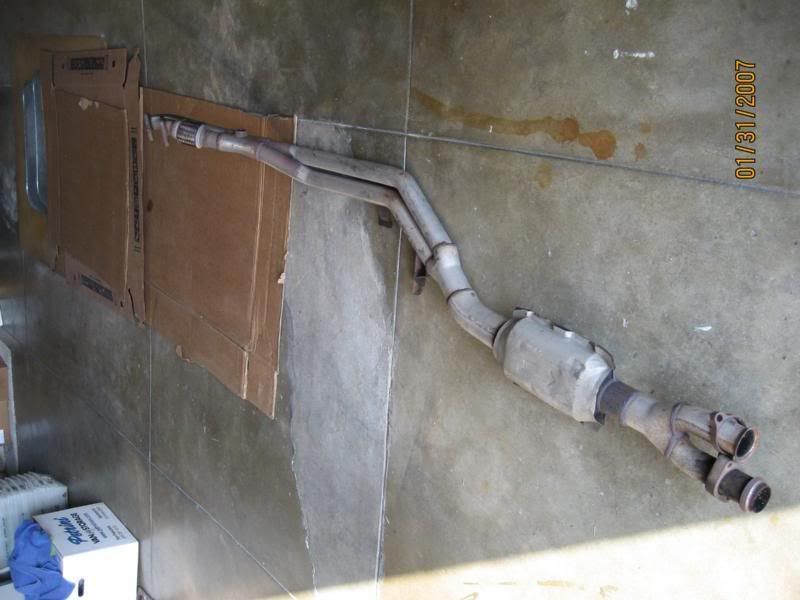

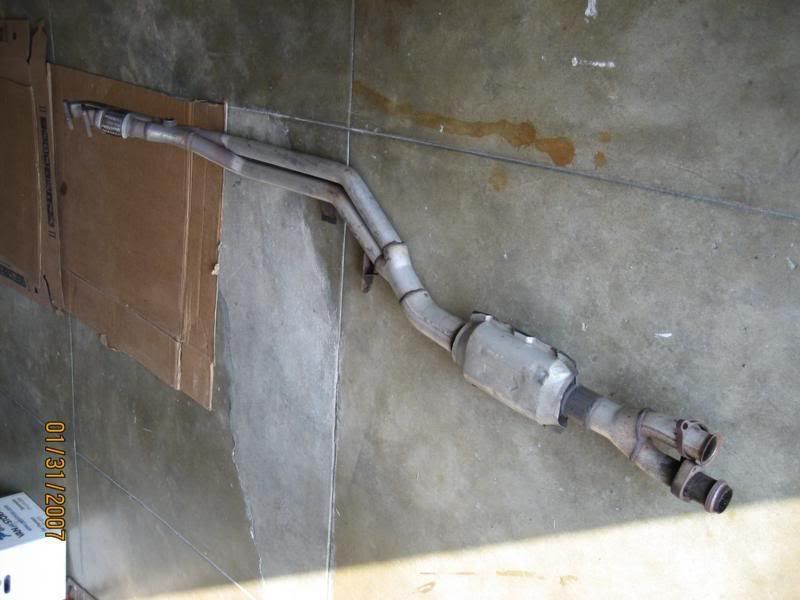

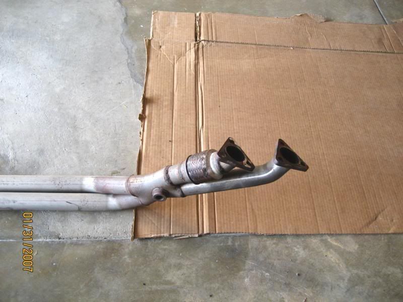

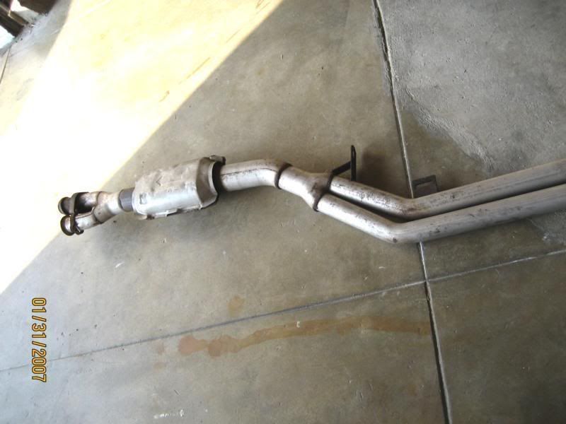

          Don't really have an answer for you. When I bought my 90 325i. It had a aftermaket cat which is too loud for my taste. I removed it and put back the stock one. Attached is the pic of it. I believe my 90' have the same set up as yours. the previous owner paid $450.00 for it. I believed is from DEC.
          Hoped the pics will able to give you some refference.
