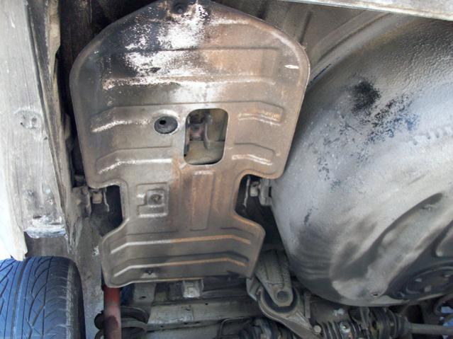

    A good Before shot. Stock hangers, heat shield. all needing to be modified.
    More Before shots.

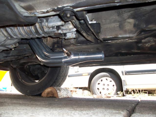

    Header after installation, simple bolt on. I did have to "modify" the heatshield on the Pass side firewall, since it contacted the header. The modification included blunt objects, and a rubber mallet. Note: at this point, I have not mounted the midpipe that accompanied the header.

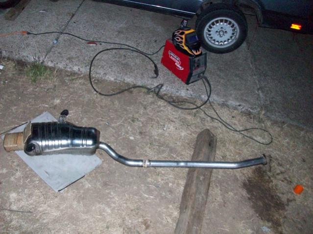

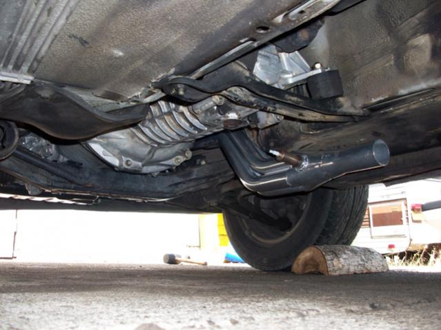

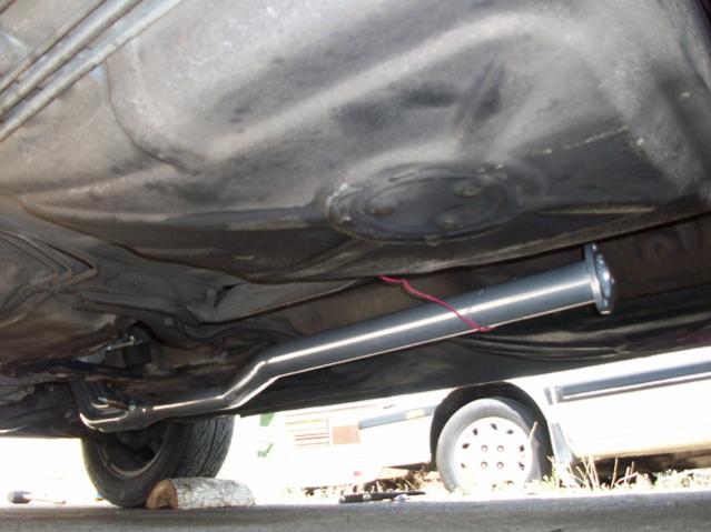

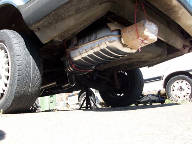

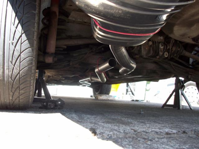

      You can see the muffler and other midpipe hanging in their relative positions here. Since I have rudimentary tools, and don't install exhausts for a living, and since this is not a bolt on job, I wanted as much layout as possible. Note the tight clearances in the next shot. 100_0189.jpg

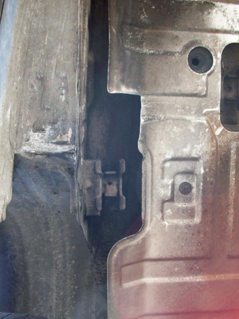

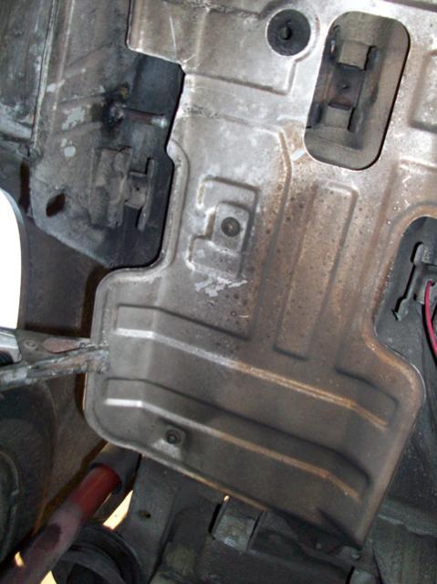

      Since I wanted my tip to show, I needed to move the mounts further to the rear of the car. Note that with my current diving board bumper, I cannot move the muffler far enough back. Since I planned on adding a plastic bumper in the very near future; however, I planned for this and moved it roughly far enough back to show the AC Schnitzer logo =) I will fine tune if I need to later.

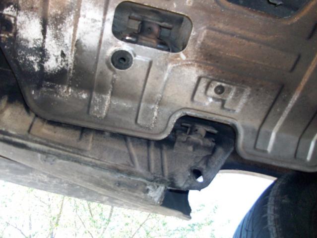

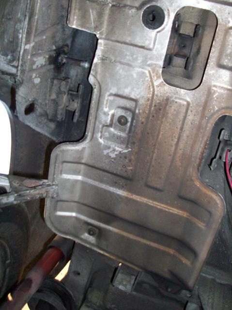

      Here is a shot on the driver side of the heat shield, where I needed to remove some material.

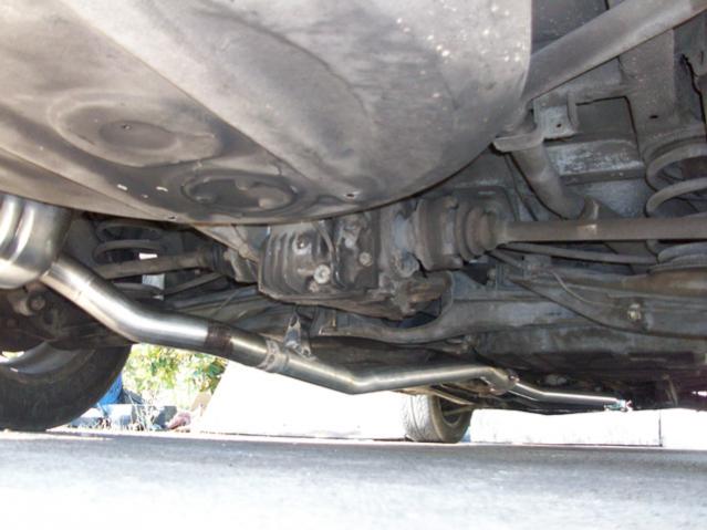

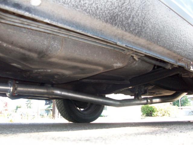

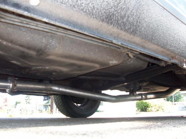

          In this pic 100_0226.jpg you can see how I reused the stock hanger, and can also clearly see the increased bend / angle on my shop bent pipe. Yes, this lowers my ground clearance. *shrug* I plan on keeping my stock height, or maybe take a 1" drop... depending on shocks. if I need to later, I can hack it out and replace it... or more likely have an exhaust shop do it =-)

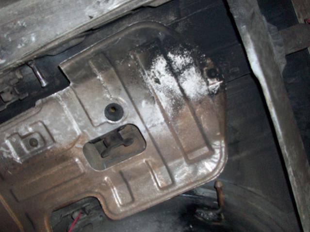

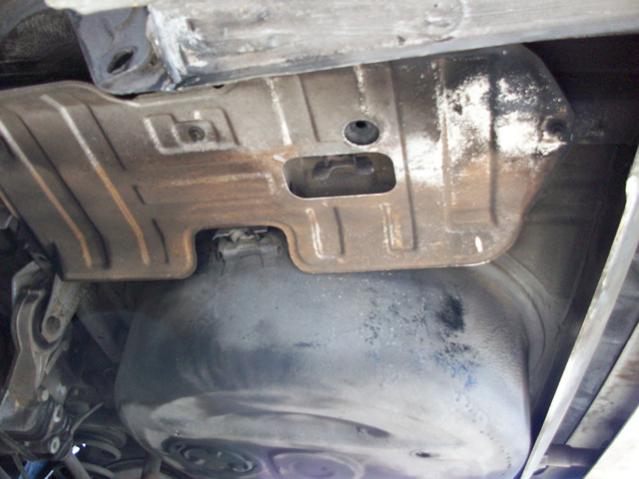

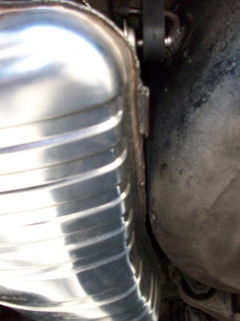

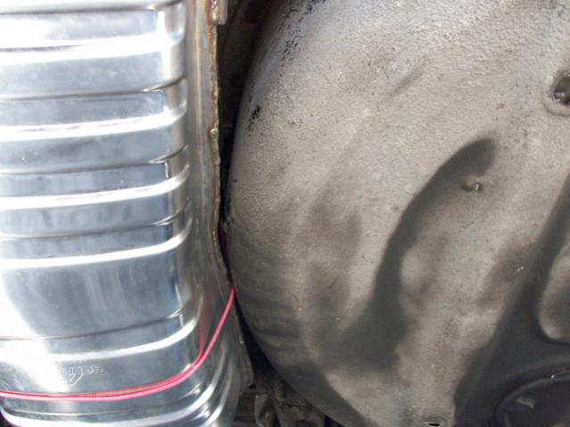

          Final clearance with the spare tire well. Still tight.
          I meant to get a shot of the opposite hanger, it was even tighter. I may knock in the trunk panel there a bit if I hear it contacting in corners. I may also drill a hole there, and put a rubber plug in; to keep the trunk watertight, and give it more clearance.
          Nice shot of the end result.

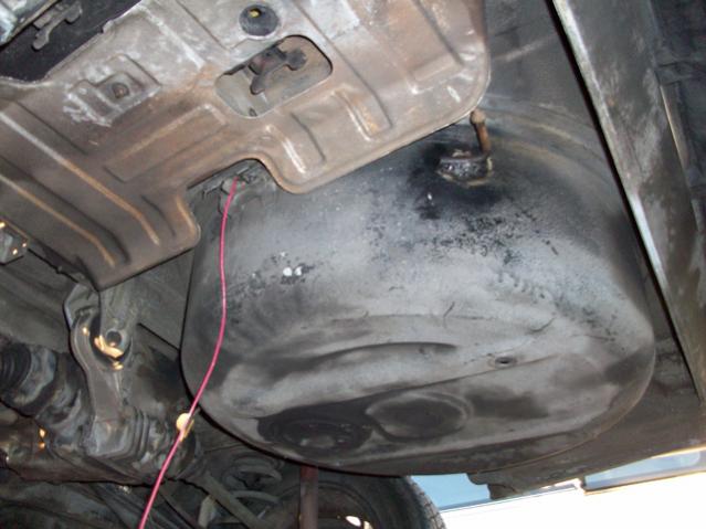

          I wanted to note that the mounting point on the rear tirewell, with the muffler installed, wants to dimple below the hanger mount slightly. The shape prevents it from denting, but this will no doubt lead to increased noise with the metal vibration. I will stiffen the structure below and to the sides of the hanger with some folded sheet metal, possibly as thick as 1/8"; in the near future.
