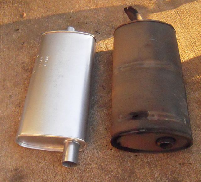

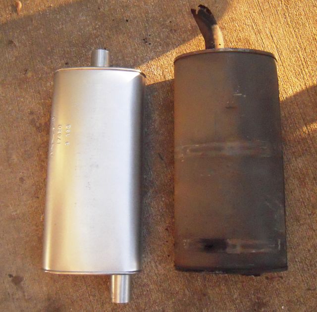

    attached are two pics of Walker Pro-Fit series 21190. OEM replacement. cut the old muffler at that inlet, new slides on over factory pipe. I welded mine but a clamp would probably do as well. very quiet muffler. 2" in/out.
    I got it off ebay w/ shipping $36

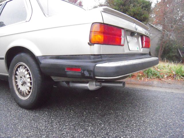

    here it is installed with straight $7 tailpipe
