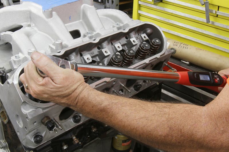

    Modern engines with aluminum engine blocks can be susceptible to damaged fastener threads, but there's an easy fix. Read the details inside!
