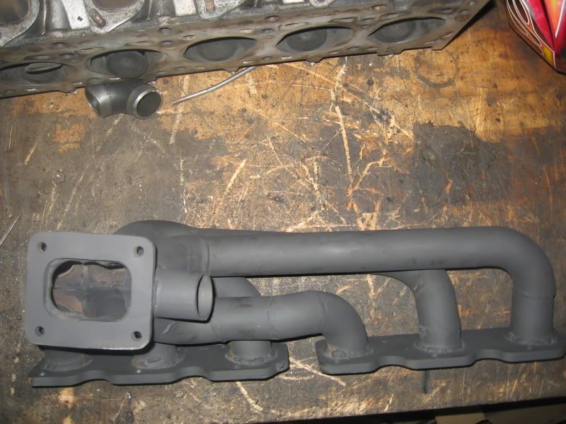

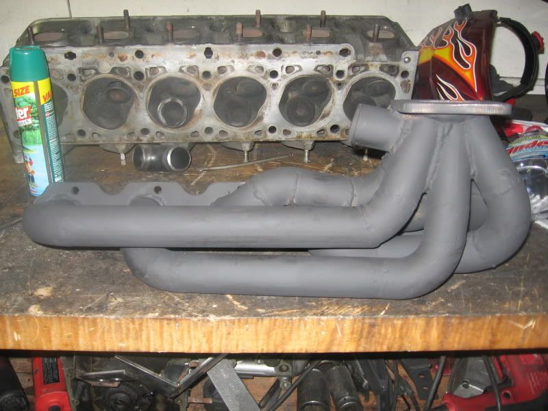

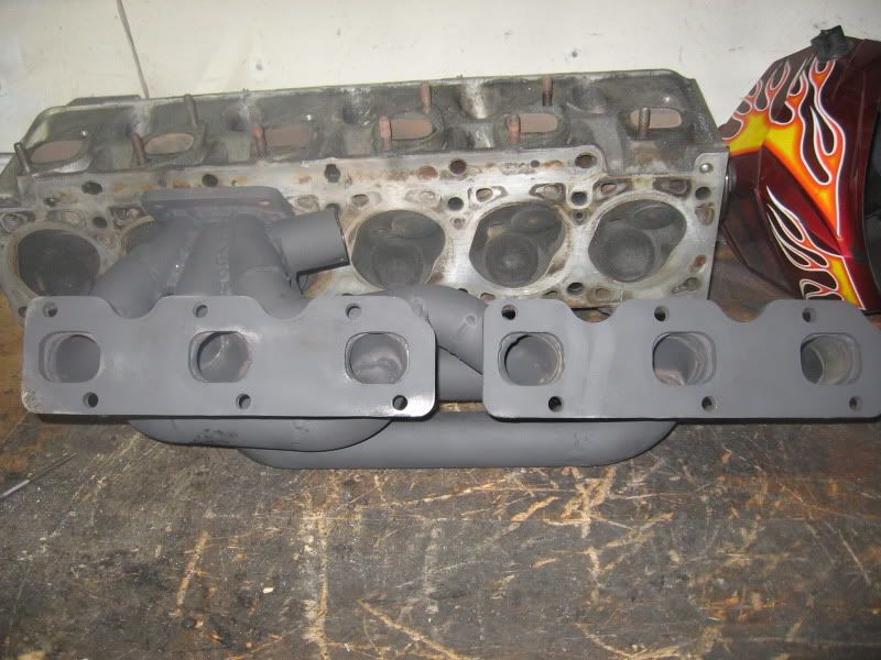

I made a full tube mani for my buddy kyle. Got the pipe from a member online but you can get it from McMastercarr. I just used a regular mig welder and all was well.
