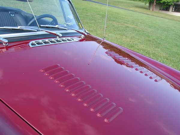

    Find a nice hot rod shop... And have the hood lourved... problemed solved
    If you do it right i will look good, just don't be tacky about it!
